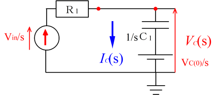

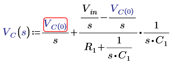

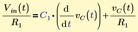

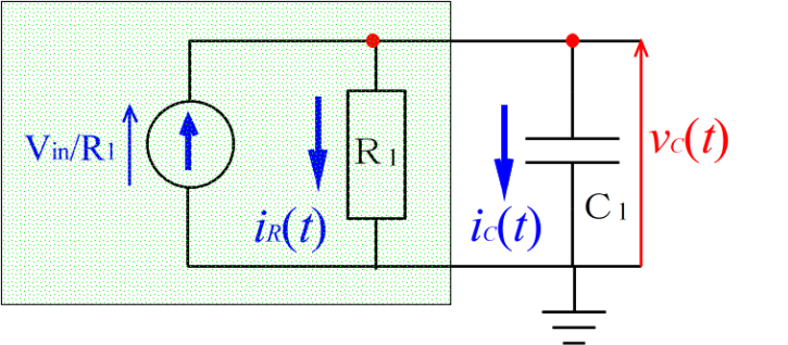

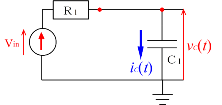

Take care to make sure all your t's are labelled the same, and likewise for the other variables.
Most probably you want this:
Then:
LucMeekes23-Emerald IVAnswer
August 31, 2022
Then:
August 31, 2022
Note that you may also need to supply the initial condition  vc(0).
