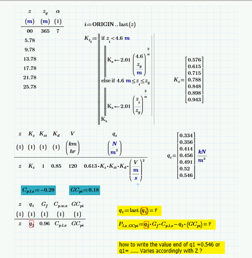

Dear All
Could you help me please ? How to write this equation in Mathcad Prime ?

what you are looking for. I see a table. Do you need a formula to calculate output as per the table based on input? Then you need to be specific what the inputs are.

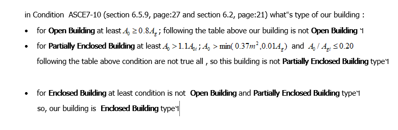

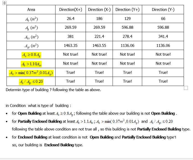

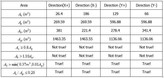

i want to write equation have condition like that.
following table as previous, thank you so much.

This still leaves much to guess!
I propse YOU start entering the information on a mathcad sheet, and make an attempt to write up the equations. If you run into problems, attach the worksheet (NOT just a picture) and provide a clear problem description.
Then we may be able to help.

You can vectorize Boolean comparisons
Prime 4 attached

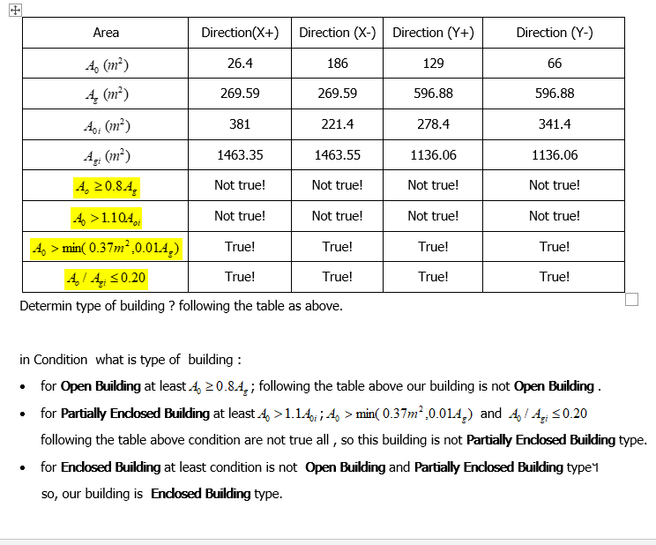

Above is condition to determine what's type building following the table above.
Please help me please sir. thank you in advance.
See if the attachment does what you want.

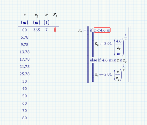

 Hi Mr. FredKohlhepp and all friends, Could you introduce me, how to write this equation please?

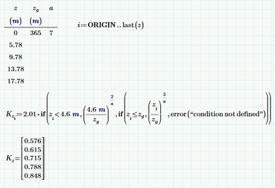

First and before all: Always attach the Prime worksheet, NOT just a picture!
1. Tables are a nice feature of Prime but they can NOT be used to display results.  Tables are for input only.
2. Z is a vector, an array of values. You need to index Z in order to address it's individual values.
3. Your first condition uses a regular m, I think you need that to be the unit m.
4. In general you should take care of ALL possible situations. What should Kz be when Z>Zg ?
Here's a possible way:
