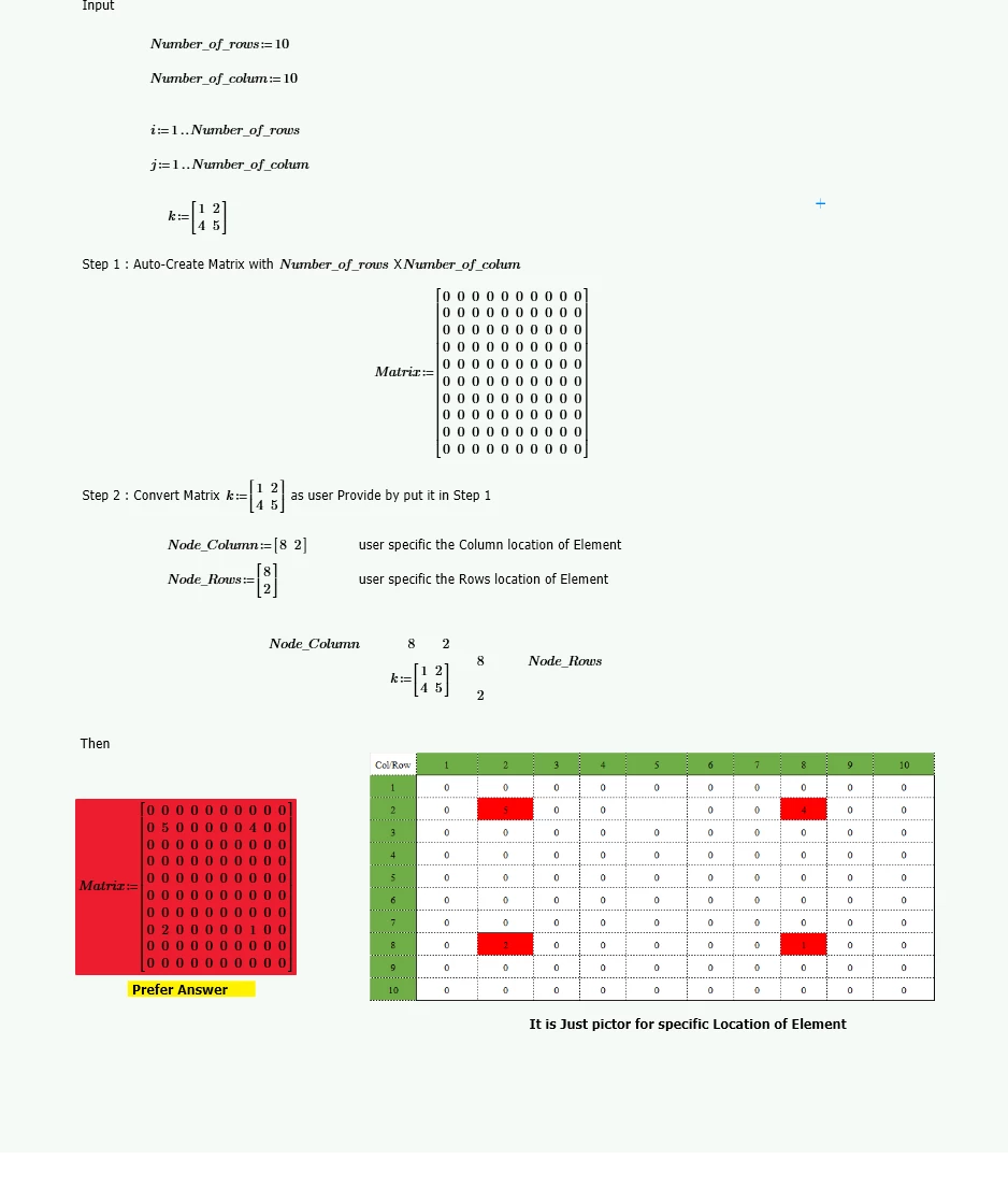

Dear everyone,
Please solve this in Attachment Picture
Step1
How to Auto-create Matrix with nxn ?
Step2
Put  Matrix provide in Step 1 by Column and Rows User Instruct.
Many thank

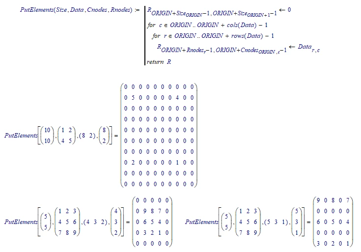

Here's a function that does what you want in one go. It creates the empty matrix (rows and columns as provided by the first parameter Size), and puts each of the elements of the provided matrix (second parameter  Data) on the respective column and row node positions (as specified by the third and fourth parameters Cnodes and Rnodes respectively). LM_20180327_PutElements.png
You'll have to type the function in Prime yourself, since I'm limited to Prime express.
But I can view your Prime sheets, so if you need more help, just come back here.

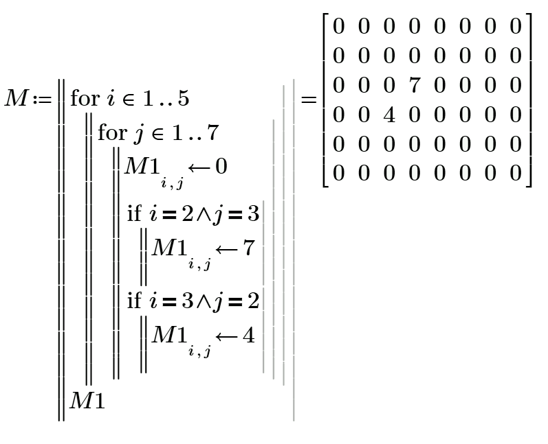

One way
autoCreating an nxn matrix.
Just set the last element to zero.
Watch the value of ORIGIN which will change the outcome.
File enclosed to demonstrate this.
Here is how to do the insertion you asked for.
File enclosed

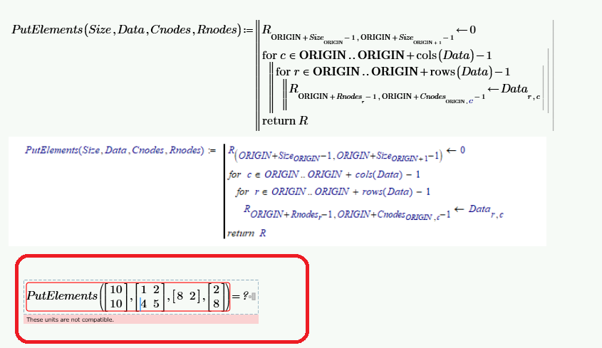

After I did your Formula in Prime, show as below+Attachment
LucMeekes
(To:SPRstructur)
Stupid error message of Prime, you're not using units here !
I guess the error is due to the autolabelling feature of Prime, Sometimes a blessing, Now it isn't.
Check your labels. ORIGIN should always be the same ORIGIN, the bold upright one, which is labelled as a 'system' type. So the Italic ORIGIN's need their labels changed.
hahaha......Smiley Very Happy
Wrong 'c', The origin is Correct!
Cheer! Success

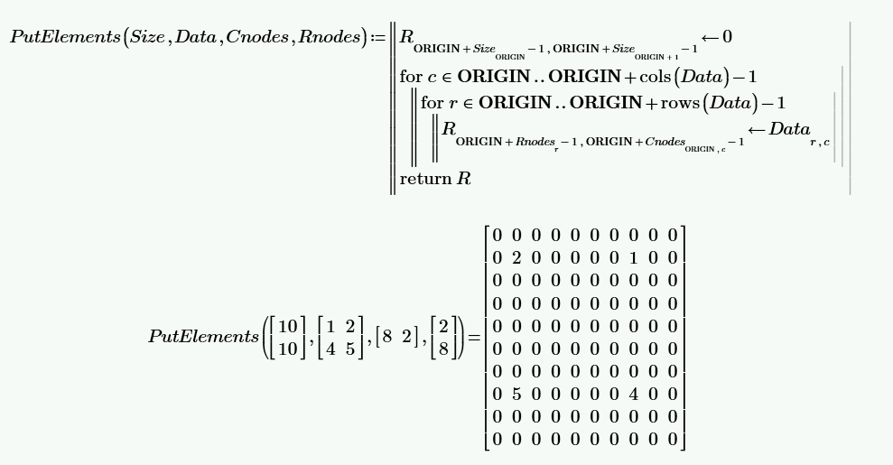

LucMeekes
(To:SPRstructur)
So now it works?
Yes
I reattach to other need this for Someone use Prime
Many Thank!
