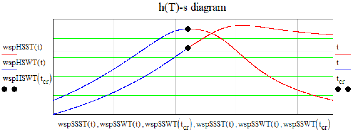

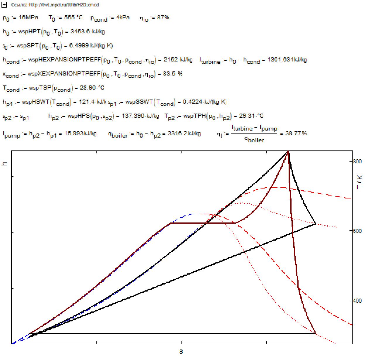

There are a h-s (Mollier) and T-s diagrams of Thermal cycles!
We can use also a h-T-s diagram in Mathcad 15
