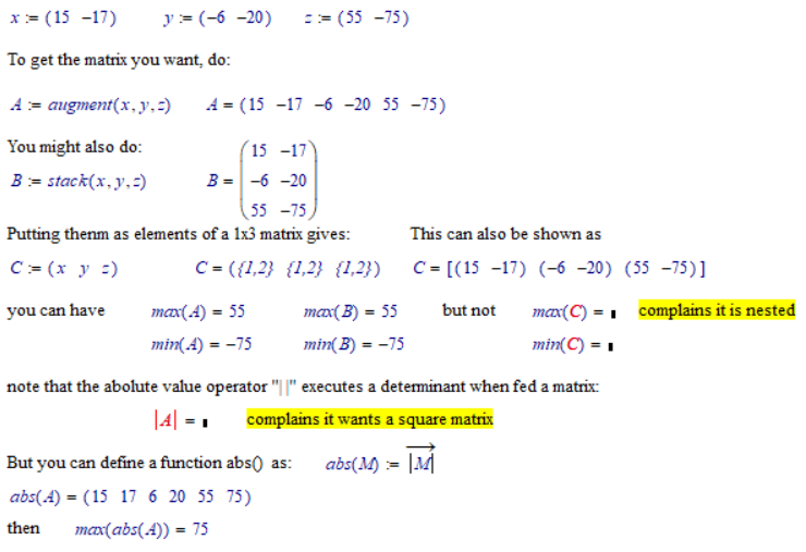

Hello everyone,
I have the following matrices:
x = (15 -17)    y = (-6 20)   z = (55 -75)
I would like to combine them to form a new matrix such as,
A = (x y z)
I'm thinking (not sure if its right) A would turn up to be a 1x6 matrix.
A = (15 -17 -6 20 55 -75)
Then I would like to get the maximum absolute value of A which if everything is possible up to this point then the result would be 75.
Any suggestions?
Thanks!

Use
A:=augment (x,y,z).
Then the Minimum of your matrix A will be found with:
MinA:=min (A) = -75
To find the Maximum absolute value use:
MaxAbsA:=max (abs (A))= 75
