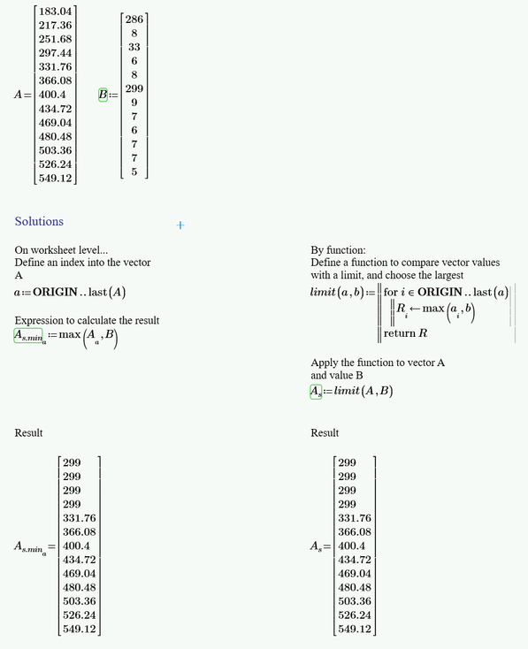

Is there a way to find max values for two columns, outputted as one column in prime 9?
LucMeekes
(To:TA_10206400)
There are at least two ways to accomplish what you want, on worksheet level and by using a function. Both are shown in the attached worksheet.

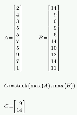

There sure is a way to do what you are asking for, but its not clear to me what exactly you need.
Best you provide some samples in a worksheet, state what result you are expecting and attach the sheet here.
What I understood from your short question was, that you want to find the maximum of the first and the maximum of the second vector and want the two values returned in a 2 x 1 vector.
Could be done that way:
P9 worksheet attached

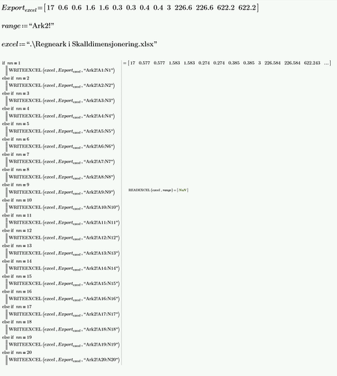

I've attached my worksheet, with a workaround solution I created to solve this issue. The attached image is from the second page.

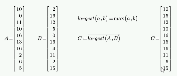

As a follow up question. If you where to compare two vectors, and compare row 1 in A with row 1 in B, row 2 in A with row 2 in B etc... Could you use a similar approach? I would assume the worksheet level approach would not allow for this.
(To:TA_10206400)
You would have to define what should happen if the two vectors are not of equal length.
  1. A has fewer values than B.
    The extra values in B may simply be ignored
    OR
    they may be appended to vector A.
  2. A has more values than B (as in your example).
    You may leave the extra values in A unchanged
    OR
    you compare them with the last value in B and replace them by this value if B is larger.

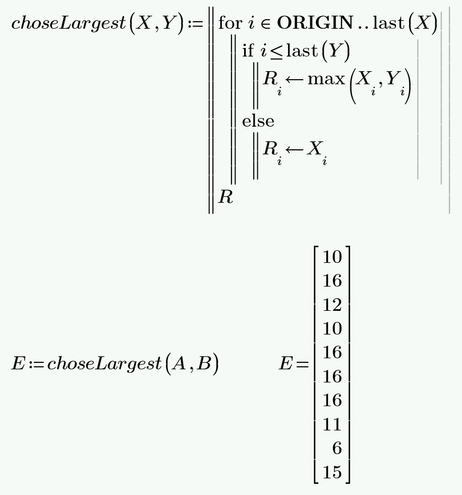

Here an approach which uses vectorization. But it only work if both vector have the same length
The function "largest" had to be introduced because the built in "max" can't be vectorized.
Here a method using ranges on worksheet level. It works If A has the same number of elements than B or fever. If A has more elements than B, then A would be truncated
And here a utility function is used. It works OK no matter which vector is larger. I have chosen the first option in my foregoing list (ignoring the extra elements in either vector).
The vectors where ment to have the same number of rows. Function "largest" is exactly what I was looking for!
If I get time in the future I want to try to make something simple with Python and MathcadPy as mentioned earlier. Hopefully if I manage to make an executable program for changing an input/output range, file path and so forth that would be the goal.
The only issue I see with this solution inside prime, is I haven't found a way of changing what column to export to inside Excel for every iteration. For my manual approach I currently did this, which I think is quite messy. The goal with Python is to also change the Excel position "Sheet1!A(n_row):N(n_row)".
