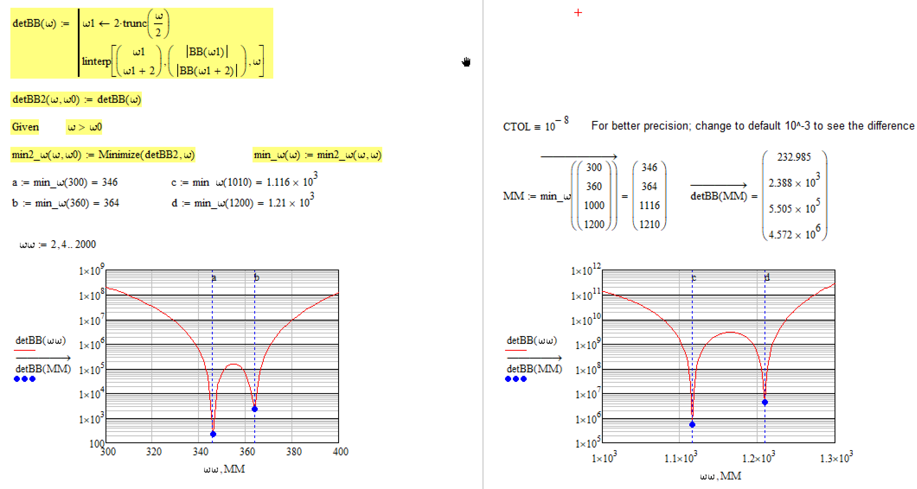

The answer of minimize will be the same with or without Given unless you write your constraint omega>700 between Given and Find.
The reason you don't get a solution probably is that your function BB throws an error when the values of omega are near the expected minimum. Try BB(345) or BB(345.5). Obviously Minimize can't play around with the value of omega without getting an error and so it settles with the guess value (just a guess).
(To:remslie)
OK, some further look showed that the problem with your solve block is, that your function BB will only evaluate for even integer values of the argument omega and fail for any other.
To find a solution Minimize will change the value of omega ever so slightly (and sure not in steps of 2) and look in which direction the function value will get smaller (the algorithms used actually are not that simple). As BB and |BB| will always throw an error, it settles with the guess.
So the first step necessary is to create a continuous function to use for minimize. I did this by using linear interpolation if the argument is not even.
It showed that this worked, but is not enough as we always would get the very same minimum at 346, regardless of the guess value. Thats OK, as it seems to be the absolute minimum anyway. So I added a constrained telling the algorithm that the value of omega always should be greater than the guess. This means that you have to chose your guesses carefully. The guess and the value the searched for value should be greater than have to be two different arguments of the solve block function and all arguments of this function must be also arguments of the function we wish to minimize (even though its not used there. This is the reason for detBB and det BB2 and min_omega and min2_omega.
Looks like it works now as you intended.

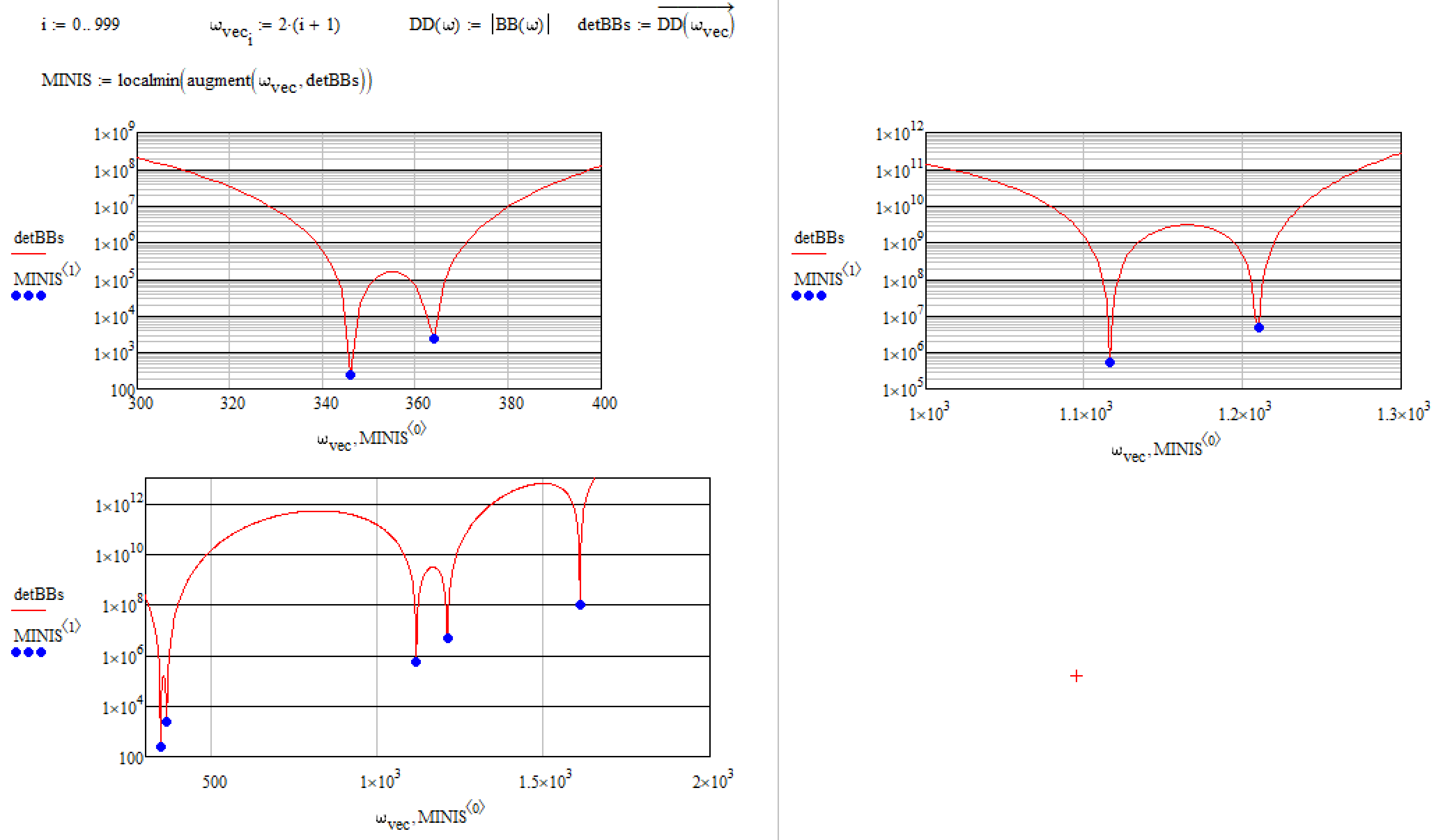

As your function |BB()| will evaluate only at the 1000 different equal values of omega, it would be more appropriate to use vectors and the function localmin from the Data Analysis Extension Pack:
remslie
(To:Werner_E)
Werner,
Looks like I owe you two beers!! The solution to Vectorize BB and use Localmin is very elegant and so efficient. How on earth programmers develop the code to process the math is amazing.

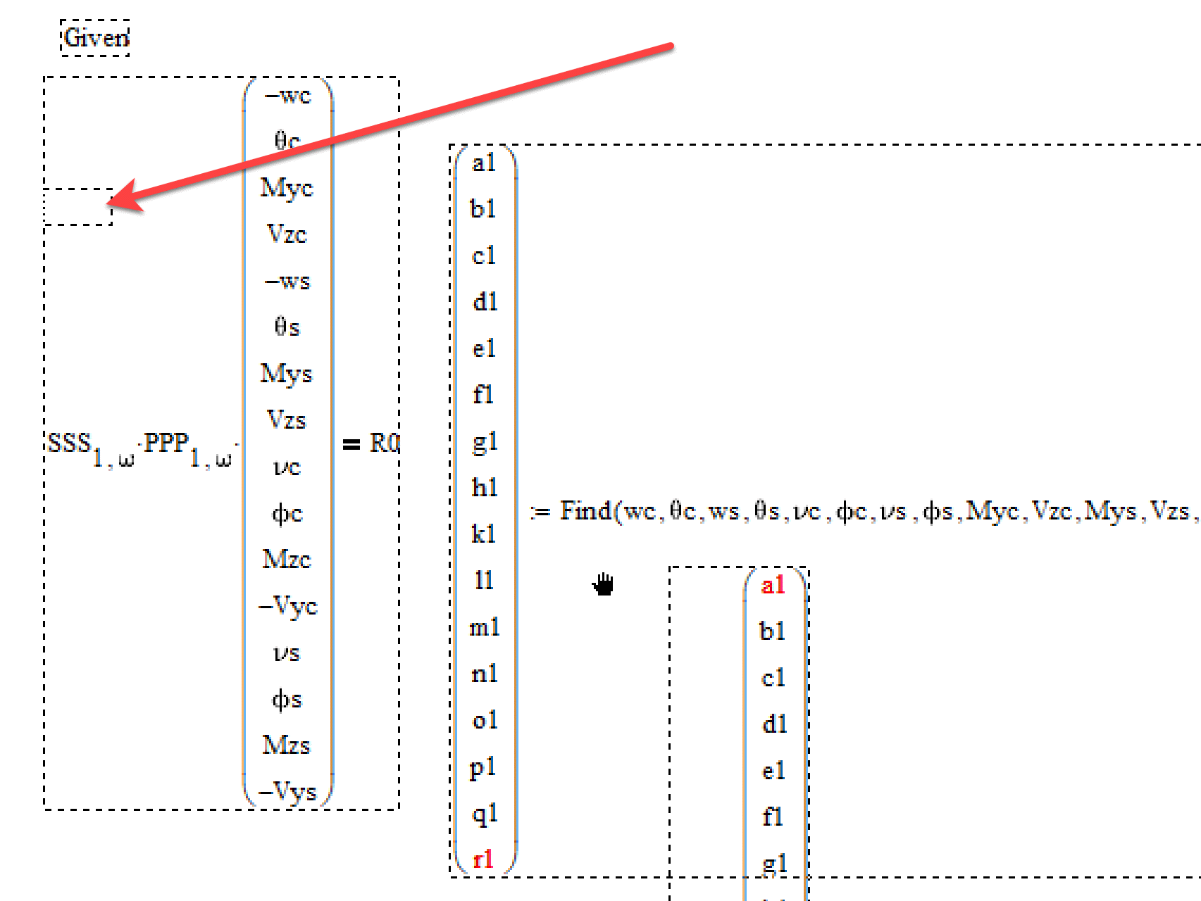

Your sheet is quite a mess with all those regions overlapping and and arranged in criss-cross manner.
What I found nonetheless looking at the first failing solve block is:
1) There is a second region with "Given" hidden underneath one of the other regions. Thats the reason for the error message.
2) The solve block will still fail and this time using "Trace Error" tells us that Mathcad was not able to find a solution within the given tolerances. Set CTOL to a higher value like 10^-4 and you get a solution.

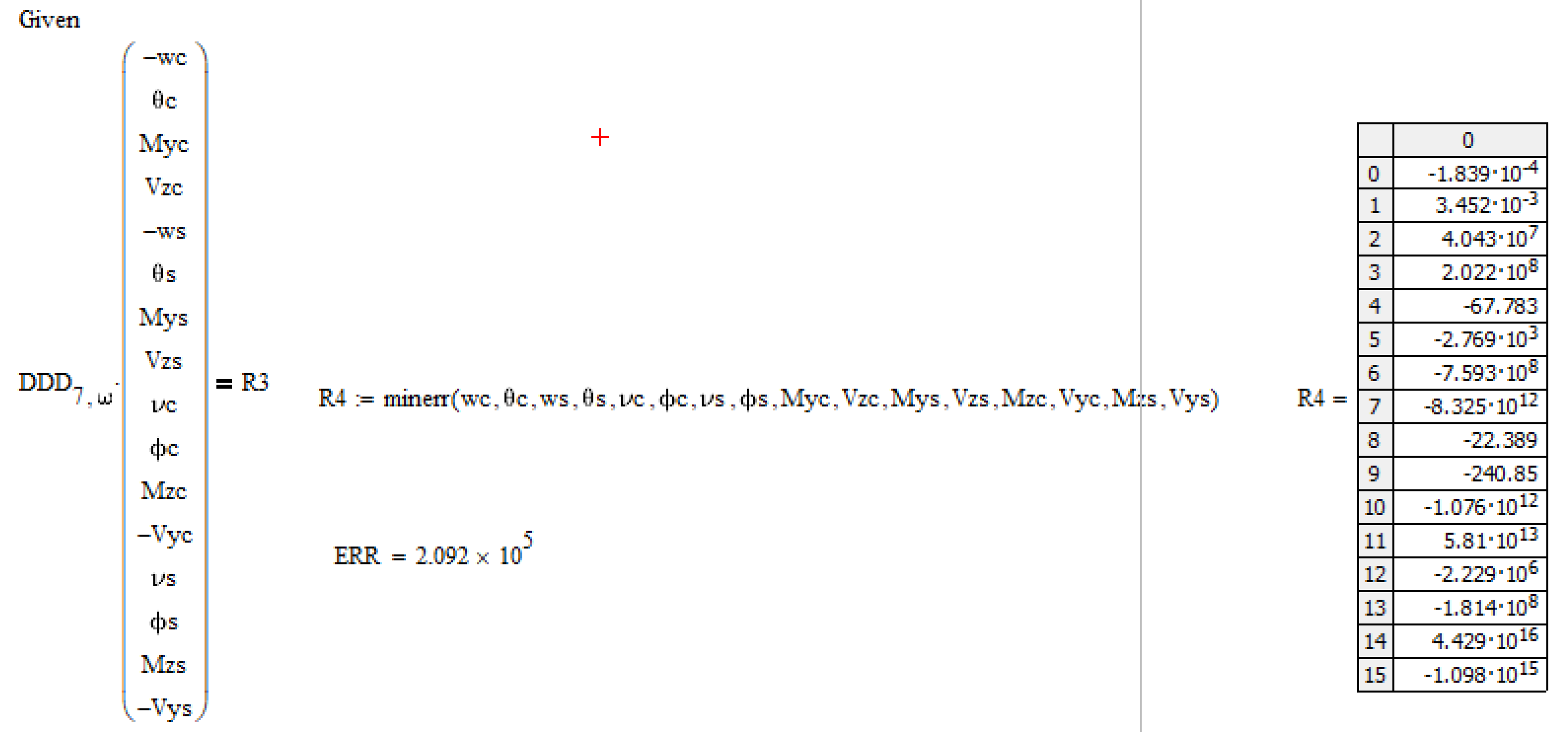

I see that you already set CTOL to (usually unacceptable) value 1. You can set even higher values if you do it in the sheet itself. Simply type CTOL:=10 at the top of the sheet or you a global assignment anywhere in the sheet. But it may be that larger values than 1 are ignored anyway (at least values that large would not be useful anyway).
I guess that your solve block failing would mean that there simply is no exact solution to your equation.
In that case you could use "MinErr" instead of "Find" at the end of the solve block. This will minimize the sum of quadratic errors. There is a system variable ERR which you can evaluate after the solve block indicating the quality of the solution. You can set CTOL back to the default 10^-3 or another appropriate value.
When looking for R1 you get the same solution as with find with ERR approx. 10^-7. But when looking for R3 and R4 you get ERR in the range of 10^5 and you have to decide if those values still are valid and acceptable for your application.
Another option for linear systems is to use "lsolve". Note that the order of the variables in the result is different from the order you demanded in the solve blocks and you will have to change some signs.

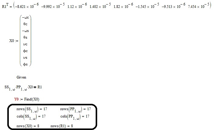

I fear that something is wrong with the size of the matrices.
RichardJ
(To:-MFra-)
@-MFra- wrote: something is wrong with the size of the matrices.
Yeah. I should have noticed that. It was getting late though Smiley LOL
remslie
(To:RichardJ)
MF, Richard, That's a touch embarrassing. In fact whilst I was noodling over the problem just before your responses I discovered the fact that the matrices are of different size. I have corrected that but I am still having problems. I will spend a little more time trying to rectify before summoning further assistance.
