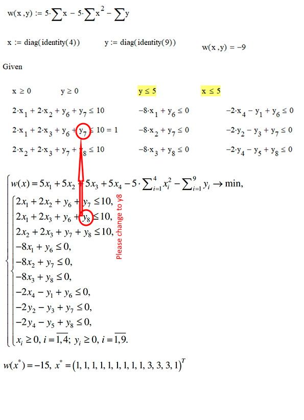

Would anyone be so kind as to point out to me why the MInimize function does not work in this system of equations?
The answer it should give for the variables are: 1, 1, 1, 1, 1, 1, 1, 1, 1, 3, 3, 3, 1.

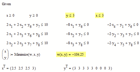

You sure have already noticed that the changes you suggest still give a much better (lower) solution that the one you expect:

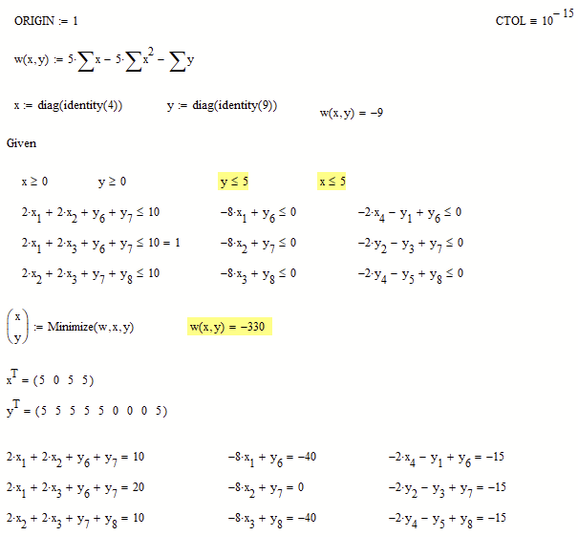

There is something wrong either with your function or with your constraints.
The value of w can be made as low as you wish without violating the constraints! Thats the reason why Mathcad can't find a minimum - the error message about a variable not being defined is nonsense but its the only error message a solve block will ever throw.
The picture shows the elements of x and y which can be enlarged for a lower function value:
If I add an upper limit for the values in the vectors, the solve block gives a solution, but not the one you expected. So I guess you'll have to check your constraints.

Please make the change of the variable in the equation indicated.
One question:
Can the objective function be worked with a single variable, w(x)?CR_Min_90121.jpg

Why do you think that the solution minimize comes up with is bad and could be improved???
You suggested a "solution"  for the minimum where w(x,y)=-15, Mathcads minimize found a minimum with w(x,y)=-104,25 which is definitely better.

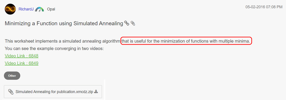

As far as I see it, "Anneal" will try to find the global minimum but there is no way to apply constraints.
CarlosRomero
(To:Werner_E)

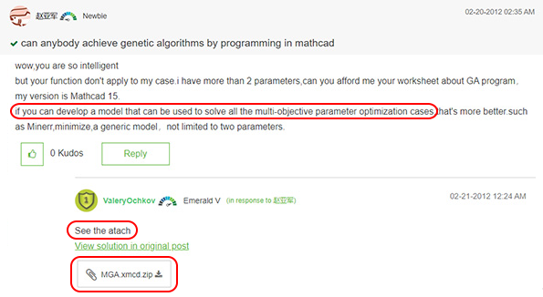

One of the follow-up posts on these algorithms was that “simulated algorithm that is useful for the minimization of functions with multiple minima”.
Another post was:
where he asks "if you can develop a model that can be used to solve all the multi-objective parameter optimization cases" and was told to "see the attachment, MGA".
I quite agree with both statements.
In my opinion, "a model that can be used to solve all the multi-objective parameter optimization cases" is correct and both algorithms can do it.
