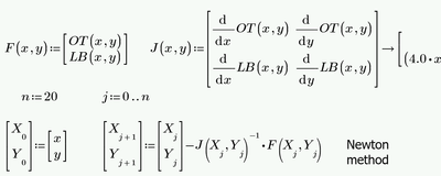

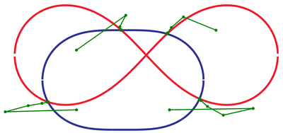

Who's to guess what's in a protected area? Prime 6 in attach. We have some tools in Mathcad 15 (trace)
12 REPLIES 12

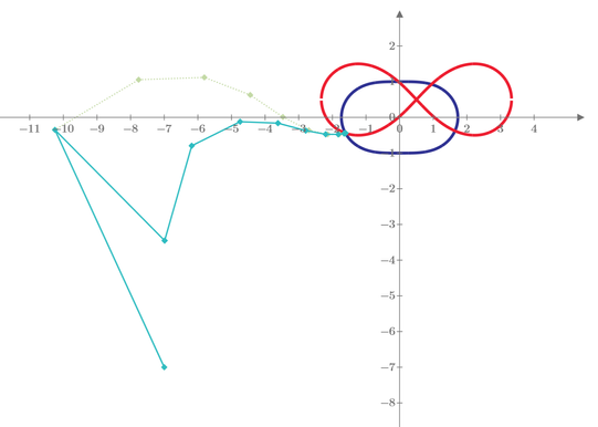

Yes, the trace command in MC15 was quite useful and is missed in Prime.
But your approach seems to be in no way a suitable replacement for it because you are cheating!
Your picture does not show what the built-in "find" command is doing but is rather showing the attempts of a different(!) algorithm which you implemented yourself - probably one of those you already posted a few times in the past.
The correct path chosen by Prime's algorithm can be seen in the following screen shot in turquoise (yours is shown in light green for comparison).
I omitted the few first values where Prime tries the result of the origin, some "extremes" and comes back to the initial values
And, most important: HAPPY EASTER to all!

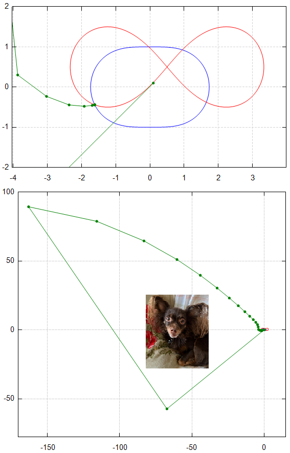

My dog named Snif approaches the food bowl in such a way - he never goes straight, but takes a big detour. I have asked him many times why he does this. He is silent.
Hi Werner!
I opened my play cards - see attachment.
Open and you - tell us how Prime can do tracing.

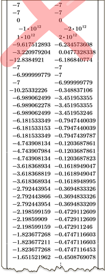

Sure, its no secret and nothing special, just a method which I often used in real Mathcad, too. Simply add a dummy function in the constraints which writes the current values to a file and read in the file after the solve block finished.
I have not kept the file but I see that I kept the screenshots. The following should show all thats necessary:
Needless to say that doing so slows down the solve block, which fortunately is no issue in case of this sheet.
I think we don't need the "ddd <--" part and could delete it. APPENDPRN would be executed anyway.
The "initialisation" of the file with WRITEPRN was done to avoid appending to an already existing file. I don't know of a way to delete a file in Prime (in real Mathcad we could use a call to the command processor to execute OS commands).
So its necessary to let the whole sheet recalculate to get the file deleted, not just the solve block with different initial values.

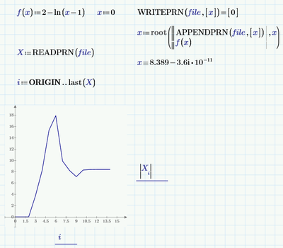

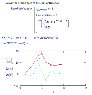

Nice method, Werner!
In Mathcad 11, you can follow the path of the root() function with a neat trick that does not require writing to a file:
Don't know if it holds in Mathcad 15. It doesn't work like this in Prime,
but you can do:
(To:LucMeekes)
Unfortunately the file-less method does not work in MC15
"k" is not saved/remembered from one iteration step to the next (the same probably would apply to v, too).
