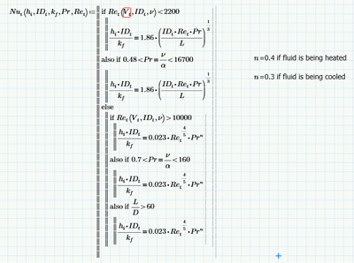

Is there any way to simplify this?

I've since seen that I have errors in the Nut function but please point out any that you may see.
Thank you!

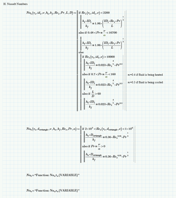

Revised

Eliminated the comparison operator as its something more for my eyes to see and left the equation that solved one part.

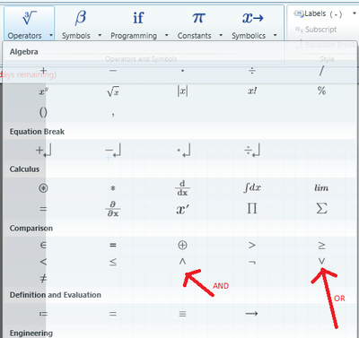

You can use an OR operator, you find it in the operators panel of the ribbon, there's also an AND operator:
Here are some examples:

Utilized the and operator to simplify the function program. That solved the other part of the problem.
