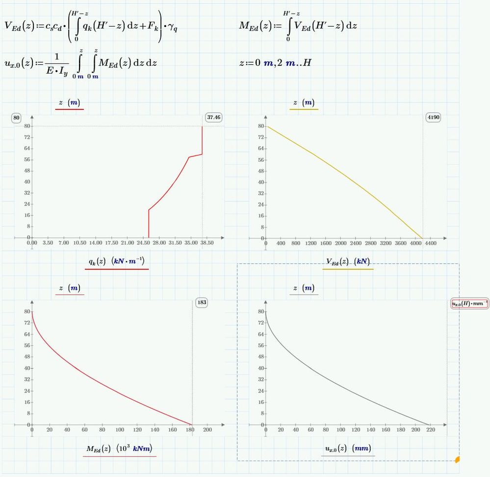

Hi all,
I'm working on on a sheet which calculates section forces and deflections in a cantilever beam based on a function for the load. There's multiple integrals involved:
  1. define q(z)
  2. V(z) = integrate q(z) over z = 0...z
  3. M(z) = integrate V(z)
  4. u(z) = double integration of M(z)
In my sheet this sort of looks as follows, where q is a ranged function, see the top left graph:PTC_forum_multiple_integrals.jpg
Steps 2 and 3 are easy for MathCAD to compute, but step 4 (bottom right graph) puts my computer in an endless loop of calculation.  MathCAD 15 also has it hard, but does come to a result after a while, where MathCAD Prime 4 is still calculating after about an hour.
I can understand that multiple integrations can be cumbersome for my computer, but in my opinion, this is what MathCAD should be good at? Am I doing something wrong somewhere, are there ways to get the last step working, or am I just asking too much of the software?
Thanks in advance for your advice!

Realize that when you integrate using a function that itself is an integral you're doing the first integration again for each step of the second.  And you're four levels deep.
What I have found that loses accuracy if you're not really careful but speeds the process is to fit a polynomial.  (Polynomials integrate very fast!)  Looking at your graphs, moment looks like a good candidate.
Develop a vector (Z) along the length.  Create a second vector of moments at each location of Z, (Mz), by evaluating your function.  (Mz = MEd(Z)).  Then use Fn:=polyfit(Z, Mz,n) to fit an nth order polynomial to that data. ( Polyfit creates a function.)  You can plot the error Mz-Fn(Z),and adjust n to control errors.
Now, instead of integrating M(z), integrate Fn(z)--should be much faster.

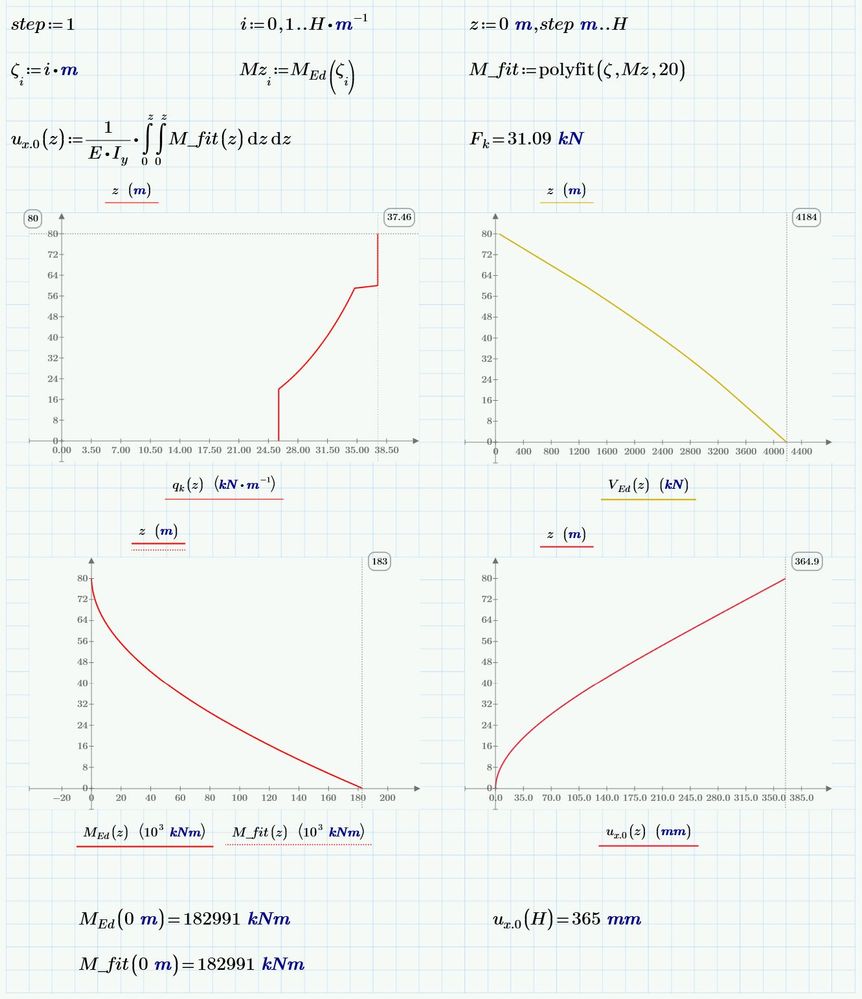

Thanks Fred, that seems to do the trick indeed!
Haven't been able to fully verify the results, but the calculation time is more than acceptable, considering what's being calculated!
