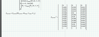

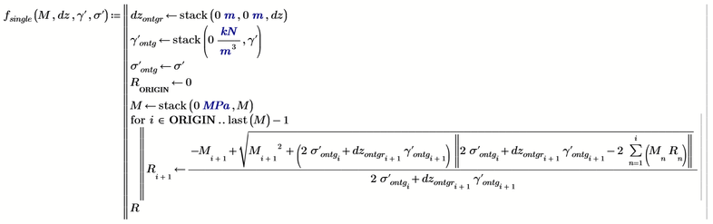

Hi there
I have a problem with this function . The issue is R is a cumulative value so the R2=R0+R1>
R3= R0+R1+R2 and so on... I wanted to implement that in this function but an error ( must be a vector ) shows
Is there a way to fix this or to write it differently
The sheet is attached prime 11

For my problem . Yes f2 still all NaN unfortunately.
in my original sheet this is the result
but I got M
I'm trying to do the same function in smaller sheet for you to use , but I got this
actually it is not important for me in this mock sheet because I have the results in the main sheet ... but I need to fix the step after to find f2 and write the correct iterator
Can you help me with this ... would you just got any results for M and fix f2 ?

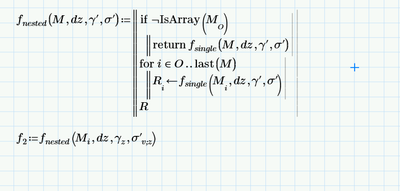

I'm trying to get a nested results for (f2) which was a result of previous calculations of (f1 and M ) for three different situations of (q and sigma and R)
in f2 function itself ( if you still remember their was a (i) and n) which were used to consider the layer of interest and n to calculate the layers above the layer of interest )
So f2 should be the result of three situations in each situation it consider the layer of interest and the  sum layers above
You showed me this > but that only for one situation

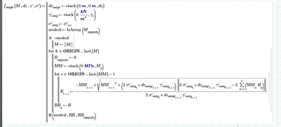

Then I asked about the loop in another thread and you showed me this ( I tried to use it in this function )
Still I got NaN
I really need you help , the sheet is attached

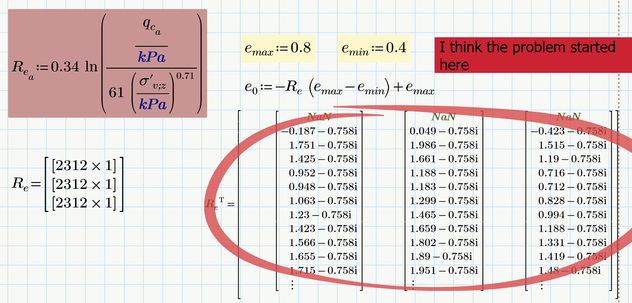

Is it expected that the values in Re are all non-real?
They have to be because you take the log of negative values (values in sigma are negative)
Furthermore your fsingle is problematic because of two reasons.
1) its already written to deal with nested matrices M
2) it does not use the arguments gamma and sigma provided bit rather the worksheet variables with similar but different names (I really would wish you would use simpler variable names without subscipts).
So this is what your fsingle should look like:
I made a simple test with real simple test values for the arguments which are just similar to the first few values of the original vectors and also considering that dz has one element less than the other vectors as is the case with your original data.

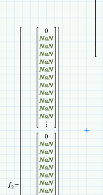

I noticed that the size of the result is 1 element larger than the size of the inputs (is this as it should be?) and also that we get all NaN's excepts the first entry because this is forced to a zero in the program which starts with the calculation of R2.
It also was clear from this test that the non-real values in M are not the reason for the problem.
The problem with the all NaN's stems from vector sigma
Its first value with index 1 is a NaN and this value is used to calculate R2. That means that R2 results in a NaN. But R2 is used to calculate R3 and so R3 ends up being a NaN as well, And this goes on and on up to the last R. So all values must end up being NaN's.
The NaN in vector dz may have the same effect as well.
I have no idea why sigma and dz contain NaN's and what the calculation you do actually should achieve and how it should be related to the input values. So I can't help anymore to fix it.
Sigma contain ( NaN) because in R calculation I need to divide (q/sigma) and sigma's first value was zero , so you advised me in the past to change the zero to NaN so I can get the results.
>> Second comment >>
Its first value with index 1 is a NaN and this value is used to calculate R2. That means that R2 results in a NaN. But R2 is used to calculate R3 and so R3 ends up being a NaN as well, And this goes on and on up to the last R. So all values must end up being NaN's.>>
So in this case I should rechange the NaN to zero ?? to get rid of the NaN in f
This is my bad I will fix it

I solved it ....> Thanks to your last reply about NaN
Thanks a lllllllllllllllllllllllllllllllllllllot
(To:YA_10963798)
Great! Glad you found a suitable solution for your problem.
Yes, I remember that you had a calculation which failed for one value and so I suggested to trap that error via try...onerror.... But nonetheless we have to return some kind of value in that case. Returning a text string with an appropriate message usually is a bad idea because this is not treated as a number and so could make subsequent calculations fail (e.g. you can't assign a unit to a string). So whenever a calculation is applied to a series of values and it fails for one of them I usually assign a NaN as the result in that case because its treated as a number and I can easily check for NaN in any subsequent calculation. Of course this means that in subsequent calculations you always must be aware that a 'value' NaN could be present and you have to write your calculations in a way so they can deal with that.
But of course it depends on the use case which value to return in case of a failing operation If infinity or  1000 MV is more appropriate, than a NaN, then assign infinity or 1000 MV instead of NaN and if 0 Pa makes more sense then assign that.
