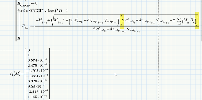

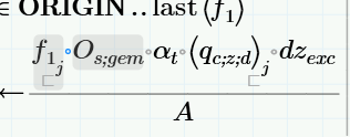

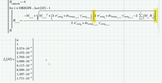

Hi there
I have a problem with this function . The issue is R is a cumulative value so the R2=R0+R1>
R3= R0+R1+R2 and so on... I wanted to implement that in this function but an error ( must be a vector ) shows
Is there a way to fix this or to write it differently
The sheet is attached prime 11

Is this value calculating the sum of the layers before?
(To:YA_10963798)
@YA_10963798 wrote:
Hi Werner
I have no idea WHAT this expression calculates, but it definitely calculates a sum of products of values based on previous R-calculations. We are calculating Ri+1, so Ri already exists as long as we define R1 somewhere in front of the loop.
You original approach
would not have calculated any sum (apart from the fact that it tried to use value not even existing at the time of calculation). Mi and Ri are simple scalar values and so is their product. There is nothing to sum up.
It's like writing
There is nothing to sum up (would need vectors, not scalars) and Prime even throws an error in that case (I would have expected the result 12).

You'll have to check if the indices (i and i+1) of the vectors sigma', dz, gamma, etc. still are correct. Lacking experience in your field of work obviously I can't do so.
Maybe you manually calculate the necessary first few values the hard way and compare if they match Prime's results.
As you tried to make that calculation ORIGIN-independent, you may replace the n=1 in the sum by n=ORIGIN.
I also noticed that you used the absolute value (actually the norm) around the second factor in your calculation, while the picture to the right of if (which you seem to try to duplicate) does not show anything like that!? If I replace the norm by a normal pair of parentheses we get different results and some of them are also negative. Not sure if the norm was done on purpose...

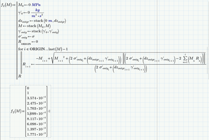

I see your point ...put in my sheet the origin is also one not zero. Why such difference occur?
You are correct I'm trying to duplicate the image to the right where ( i) is the layer of interest and (j) should be also the layer above the layer of interest. However the first layer has zero stress and I do have to include it in the calculation so I used ( i) as the layer above the layer of interest and (i+1) as the layer of interest.
Now for ( R*M) they should be the sum of values of ( R.M) in the layers above the layer of interest.
The end results of (f) should be between zero and one . I don't think having negative values is correct .
But I didn't understand why writing n=1 is different than n=origin when the origin in the sheet is 1
(To:YA_10963798)

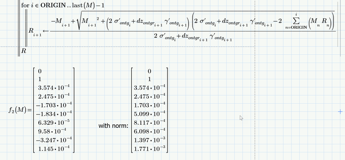

n=1 is NOT different from n=ORIGIN because, as you noted yourself, you have set ORIGIN=1 in your sheet.
I just suggested to use ORIGIN instead of 1 because I saw that you used ORIGIN instead of 1 in other places as well so that the calculations should be independent on the actual setting of ORIGIN.
The difference in my screenshot is not because I replaced 1 by ORIGIN in the sum but rather because I omitted the norm(absolute value) you had around the second factor and replaced them by a pair of normal parentheses.
I just noticed that there is no absolute value or norm in the picture to the right of your calculation so I thought I'd mention that.
I can't comment on the correctness of the values, though.
YA_10963798
(To:Werner_E)
Hmmm I understand your point . without the absolute to prevent the function from having negative values otherwise mistakes can occur

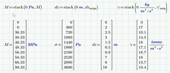

I modified the calculations to use range variables and don't use a program.
Maybe that way its easier for you to follow the calculations step by step and find the problem.
Basically you use these vectors:
and make this calculation (basically a recursion)
So you can compare the effect of the norm/absolute side by side.
Some things I noticed (and I am not sure if they have any meaning or are intended anyway):
  • You stack M on top of 0 to come up with the same number of elements in M as in sigma.
    But that way the vector M starts with two(!) zero values. Not sure if this was intended.
  • The first (zero) elements of vectors dz and gamma never are used in the calculations
  • The last element of vector sigma (3600 Pa) never is used.
YA_10963798
(To:Werner_E)
Yes exactly this is why I used stack function for M
Thank you for pointing that out
I will try both and see

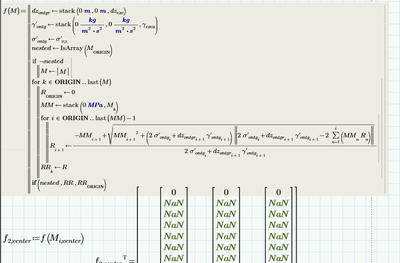

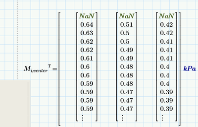

Ok But why if no error occurs , the results will be all (NAN)
What does that imply ?
(To:YA_10963798)
Can't comment on the values (NaN) and resulting data structure without seeing your actual data.
Maybe you can set up a simplified demo sheet with smaller vectors (and simpler variable names 🙂 ) which still shows the problems you encounter.
YA_10963798
(To:Werner_E)
I used the last sheet you sent and I just changed the first value of M to NaN , then I  all got f2 = NaN
I guess because f1 has NaN , in my sheet I calculate f1  and q first and they have NaN in the first row
and then I calculated f2 and M which they both have q in their functions .....but the results were all NaN
(To:YA_10963798)
Again, I can't comment on this without seeing the actual data and calcs you are doing.
All I can say that all four methods I had shown work OK even when the first element in each vector is a NaN

(To:YA_10963798)
Solutions, functions, etc. which are posted here usually are written for a specific data structure of the input quantities. It should be not surprising that they don't work as expected if you use inputs with different data structure.

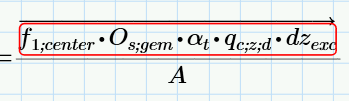

Your screenshot yesterday
showed that f and q should be 3x1 matrices (3 rows, 1 column --> a vector).
In the sheet you posted the data you provide (f1, qz) are 1x3 matrices!!
That makes a huge difference and so the solutions suggested sure can't work!
Furthermore your sheet does not show the effect with the all-NaN vectors you describe and show in your screenshot!
Your sheet simply throws an error at "last(R)" because "last" only works for (column) vectors, but R=f1 is not a vector. Its a 1x3 matrix (in math we would call it a row vector) which is not considered being a 'vector' in Prime.
Sure we could rewrite the program to work for 1x3 matrices.
Or we turn f1 and qc into valid vectors by simply transposing them. As you can see the function works OK as soon as we do so
Nonetheless I would omit the first line (R<--f1) and use last(f1) instead of last(R). But it should not make any difference.
I guess that your original data actually are true vectors and that means, that there may be something different in those vectors which is responsible for the all-NaN's you experience. At the moment I can't think what it could be.
Are you sure that each and every element in your nine 1654x1 vectors is either a normal scalar or (just the first element) a NaN?
