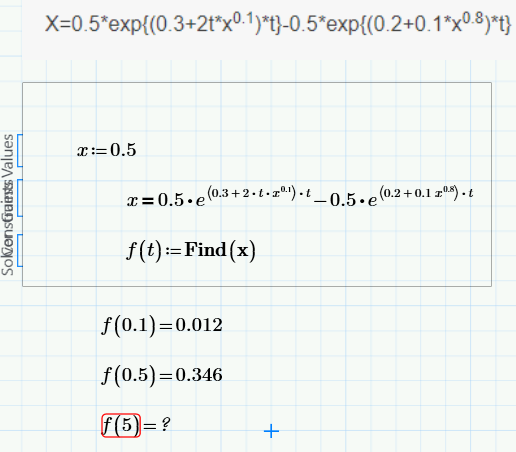

Need help solving one unkown one equation in mathcad
Handyperson
X=0.5*exp{(0.3+2t*x0.1)*t}-0.5*exp{(0.2+0.1*x0.8)*t}
I need to solve it in t=0.1,t=0.5,t=5
But I am having problem in math cad...
3 REPLIES 3
With a  solve block turned into a function called simply "f".  Not solvable for t = 5?
Sorry a plus sign should be a minus sign.
Thanks a lot !
