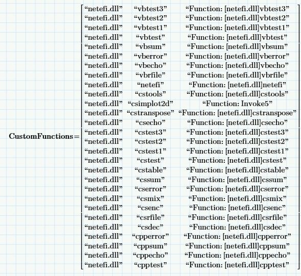

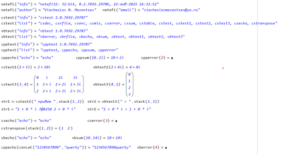

Jul 2, 2014 11:56 AM UTC
Updated (github).
Now you can use context:
public bool NumericEvaluation( object[] args, out object result, ref Context context ) {
//while ( !context.IsUserInterrupted ) { }
if ( context.IsDefined( "vbecho" ) ) {
context[ "vbecho" ].NumericEvaluation( args, out result, ref context );
} else {
result = Evaluate( ( string ) args[0] );
return true;
public string Evaluate( string text ) {
return text;

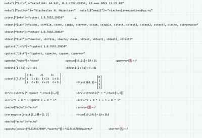

Jan 22, 2021 9:14 AM UTC
Updated (github).
How it works (rus): Внедрение кода с пользой
Tested for MC15 M050 x32 and MC Prime 6.0 x64. Now you can use .net (c#, vb.net, c++/cli) user functions in x64 Mathcad Prime.
[22-01-2021]
- 64-bit support added.
[21-01-2021]
- TComplex changed to .Net Complex from System.Numerics;
- refactored.
[19-01-2021]
- added support utf-8 for result string;
- added example project "capture".
[18-01-2021]
- only for 32-bit systems;
- mc15 m050 tested;
- .net 4.0 supported;
- examples for vs2019.

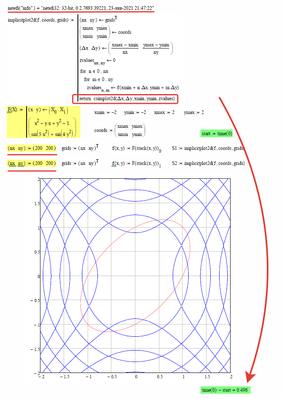

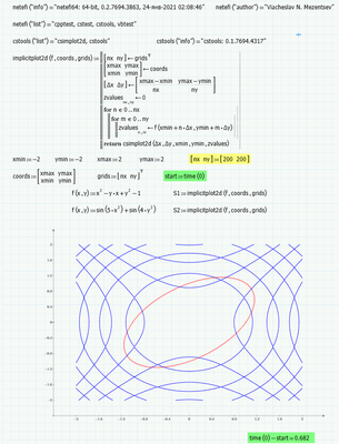

Jan 23, 2021 5:15 PM UTC

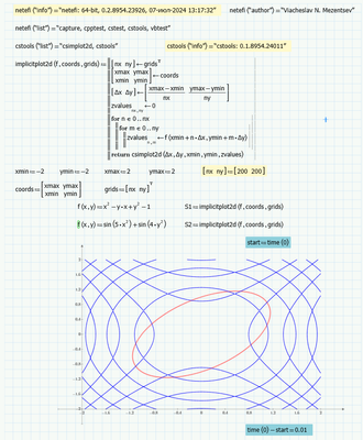

Now we can increase the speed of calculations. In this example in 5 times. Part of the function is implemented in the plugin.

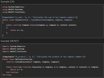

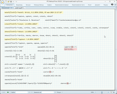

Jul 7, 2024 8:46 AM UTC
Mathcad Prime 10.0 x64 also supported.
