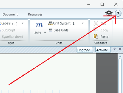

It takes time and effort to learn Prime. If you want to read how to use it, start with the online help, it is found here:

Thank you for answering my questions. I have so much to ask but I guess I cant let you answer all of it. I'll try the help button, was hoping there is a manual for all the commands. Again, I really appreciate your effort.

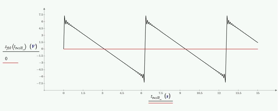

Attached you will find the worksheet for PRIME 7.
The file consists of three sections: the first concerns the input of all the data, the second the programs (subroutines) for the development of a given function in Fourier series and finally the third which contains the functions and graphs.
