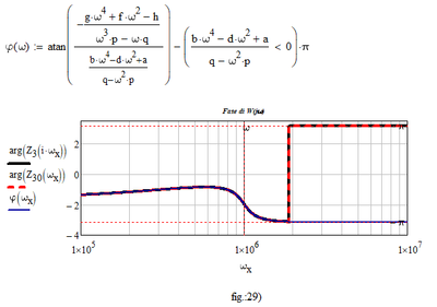

Why, in figure 29 of the attached worksheet, do the phases not coincide? And in general, if I have made any mistakes please let me know. Thanks very much to those who will answer.

Attached is the version with corrections.

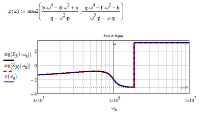

Because its wrong to just use "atan (Im(z)/Re(z))" to get the phase for any complex number z. To get the correct result you'll have to add or subtract pi if Re(z)<0!
Adding pi gives you the phase in the range ]-pi/2; 3 pi /2] and looks like this:
Subtracting pi forces the phase to ]-3 pi /2; pi/2)
You may use "atan2" instead of "atan" in your function phi to get the very same results as you get with "arg", that is a phase in }-pi; pi]
Using atan2 also has the advantage that the case of Re(z)=0 is handled correctly and does not throw an error!
Of course "arg" would do the job equally well 😉

Right, we talked about it a while ago, but I had just forgotten it. Thank you.
