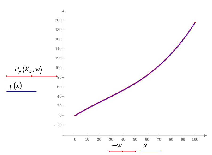

Please see the attached Mathcad 15 file. I am doing incremental solution formulation to trace a nonlinear curve.  the only step that i am not sure about is how to plot the  incremental solution (blue curve). I appreciate any assistance!

Something like:

Something like:

Thank you so much Luc!

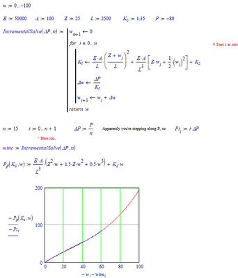

Hi Luc,
How can I make the first value for P is zero and corresponds to w=0? Right now the first value for P corresponds  to w=0 causing an upward shift.

Like this:
You should note/know that by default, Mathcad starts indexing arrays at 0, not at 1.

(To:LucMeekes)
Thank you Luc!
