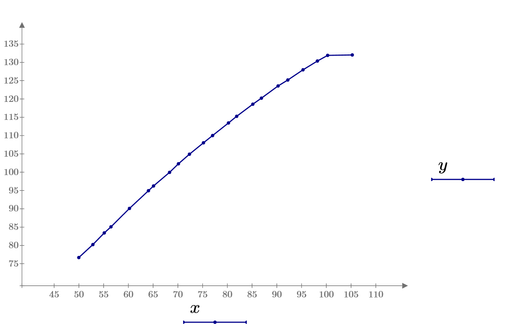

To plot the whole vector y over x you don't need any range to index the vectors. Simply put the vector names in the plot placeholders:
Of course you may also show both traces in the same plot
