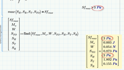

(To:LucMeekes)
Some additional remark:
I removed the angle theta from the solve block as its not used in the calculation. After you derived a suitable value for Sf.max you can easily calculate this angle using the derived value.
You can add constraints in the solve block.
For example I demanded Sf.max to be greater than 3 Pa (and not around zero as in the solution otherwise suggested).
As you can see in the screenshot, Prime assigns exactly that value to Sf.max and adopts the other values accordingly.
But when I change this constraints to Sf.max > 4 Pa (or higher), no solution is found. So if you expect a value around 700 MPa as your guess suggests, I would suggest that you check your formulas.
We finally arrived at seven equations in seven unknowns, but the fact, that my constraint resulted in a quite different solution and that changing the 3 Pa to 2 Pa and 1 Pa also yield different solutions, may suggest that your seven equations are not independent - a further reason to double check the equations.
