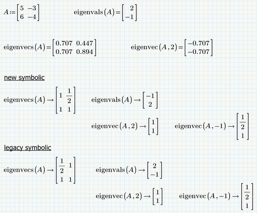

Eigenvalues are unique, but eigenvectors are not. Its up to the program which representative to choose.
Which one would you prefer?
Prime sometimes even delivers a different representative if asked for an eigenvector to a specific eigenvalue. Try eigenvec(A,2) in your example.
You may prefer the results of a symbolic evaluation. Here the order differs depending on whether you are using the new or the old symbolic engine (both available in Prime 6).

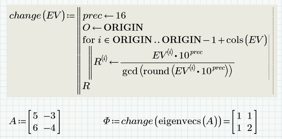

(To:Werner_E)
If you insist on integer numbers, you may experiment with this routine, but keep in mind that multiplying numbers by 10^16 gets to the limit of precision of IEEE format. It also would work for real numbers only.
