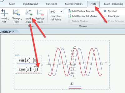

I have generated three plots for different z or distance
now i would like to compare the width of axial maximum and the width of central maximum is the value r from 0 to the point where the cure achieves zero.
I want to normalies and assume the value achive r=0
and i want to divide all values of I of I(r=0) how its possible to do this in mathcad
please help!

(To:RA_10315344)
Simply do it as you wrote.
In the plot at the placeholder for the function you simply type in I(r,100)/I(0,100) instead of just I(r,100).
You may also plot all three graphs in one plot region using different colors. Guess you know how to add a second and third trace by either using the menu or by just typing Shift-Enter.
For further questions I would suggest that you attach your worksheet.

(To:RA_10315344)
About adding further traces
Its also not wrong to consult the help
https://support.ptc.com/help/mathcad/r9.0/en/index.html#page/PTC_Mathcad_Help/about_traces_and_axis_expressions.html
When  I asked you you attach your worksheet, I did not mean you to send a full screenshot picture but rather meant that you should attach the Prime file itself. You can do it by drag and drop or by browsing:
EDIT: I just look at the definition of your function I(r,z).
Changing z does just mean a scaling in ordinate direction. So when you "normalize" by dividing by I(0,z) you get the exact same function/graph, basically you cancel al the factors and what you see is the square of the Bessel function J0(k.0*r*sin(beta).
So of course you could not see any difference if you plot all traces in one plot - they are exactly the same!
