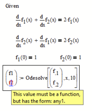

(To:JH)
My guess is that Mathcad fails in creating  a non-singular derivative matrix it needs for its numerical algorithm.
I get the same error with this simple (pathologic) system, which obviously should have the solution f1(x)=f2(x)=e^x
