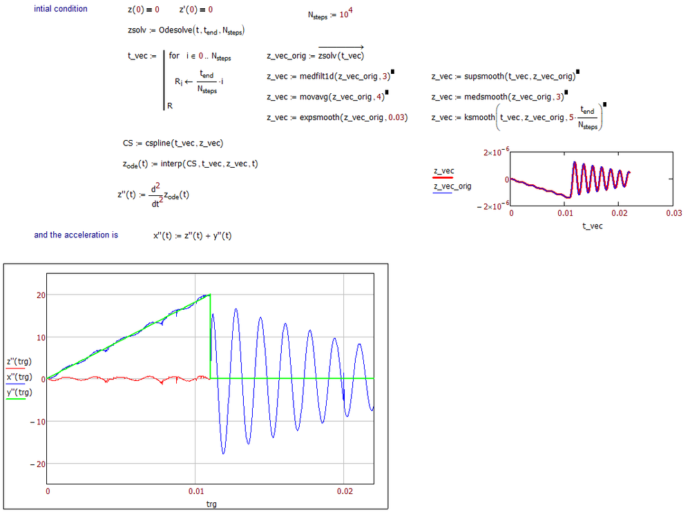

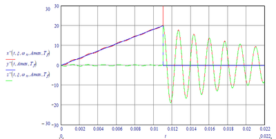

I am looking at the ODESolve with a “saw tooth” input (y’’) and I get a very spiky response – see attached (mcad 15 wsheet will follow)
Why is that?
Tried different time steps but always get this rather spiky response

Works better as set of first order equations:
Avoid numerical differentiation wherever possible!

Would suggest that you attach your worksheet.
Would adding more steps in odesolve (third, optional argument) be of help?
Maybe worth a try although i guess that the problem stems from the numeric derivations and not from the result of odesolve.
Hard to be of more hep without having the sheet to play with.

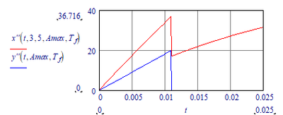

I guess Amax=20 and tf=0.011. What are your values forLucMeekes_1-1668548279451.png and LucMeekes_2-1668548298092.png  ?
If they are 3 and 5 respectively I get:

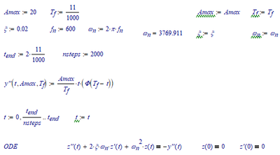

can't find the option to edit original post ! attached mcad 15 worksheet.
The Prime 8 conversion is not quite working. Does not like the y''(t) notation

Still not perfect, but maybe its helps
Its interesting that even lowing the number of steps from the default 10^3 to 10^2 give a coarse but mainly spike-less result.

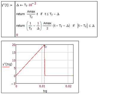

Maybe the transition back to zero be done in a zero time is creating some sort of infinity in the process
Maybe I'll try to have a the ramp-down i.e. max-back to zero in a very small time step
(To:JXBWk)
No, I already tried and it didn't help.
Actually odesolve creates a couple of discrete points and performs some sort of interpolation behind the scenes to be able to provide a function. You may do the very same manually but use some sort of smoothing before applying interpolation.
I found the expsmooth seems to provide a good result and using it the numeric derivative seems to produce less spikes. You may also play around using different interpolation methods (lspline, pspline or maybe simple linear interpolation).
But as long as we are dealing with numeric methods (odesolve and the derivative) we have to reckon with artifacts of some kind.

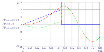

OK, the true answer is probably this:
and stems from:
With those,
and using https://community.ptc.com/t5/Mathcad/Toolbox-Solving-Ordinary-Differential-Equations-symbolically/m-p/689336
we can:
(note that these expression run much further to the right of the vertical grey line).
Compare to the numerical approximation by Odesolve:
Note the difference in z''<>Z'':

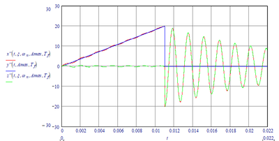

Ah, apologies. I made one mistake, sign of y''. With the correct sign the result is:
And that results in:
And the comparison with the Odesolve result:
Now the results match better.
With that corrected, you were wondering about a lower value of wn, How about f=60 instead of 600.
And the comparison with Odesolve shows as:
