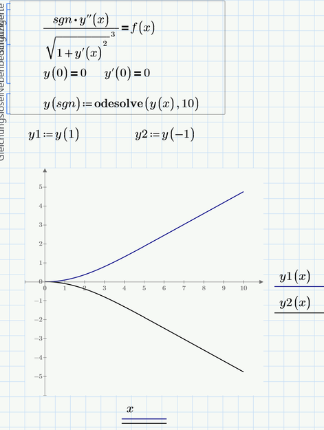

Is it possible to solve the ODE in attach?
Thanks!
How about
You can avoid the numerical glitch at about x=7.7 seen in the pic either by setting TOL to 10^-6 or lower or by adding 10^5 as the third argument (intervals) of the odesolve function
The derivative of the function y(x) you are looking for, so y'(x), is (+ or -):
where c is a constant.
Proof:
To find y(x) you have to integrate this function y'(x), which will give you another integration constant.
