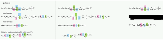

Hi everyone,
As a chemical engineering student, I am trying to solve a pipeloop problem.
I stated all the necessary balances (see below):
And the other necessary formulas:
which I want to solve for Fh(v),Fo(v) and Fc(v) from v=0 until v=VL.
now I've set up this solve block:
which in theory seems solvable, as there are 5 unknowns and 5 equations.
Is this the correct way to solve this problem?
With kind regards,
Tim

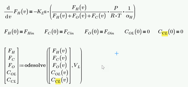

You have a couple of errors.
The functions you are looking for are functions in just one variable (v) but you sometimes used them as if they were functions in three variables.
Sometimes you simply wrote F.C (as if it were a simple variable) instead of F.C(...)
In the IC you had a typo and wrote C.CL twice and were missing C.OL
You have to solve for ALL unknown functions even if you are not interested in C.CL and C.OL
This should help (worksheet attached):

But in that sheet I did not change anything outside of the solve block and I guess I also mentioned all changes I applied in the text. At least all changes done can be seen in the picture I embedded. You see there quite clear the five equations, five initial conditions and how odesolve is told to solve for all five functions.
I did not change anything else so I also did not change your definitions of qo(..) and qc(..). And COL(v) and CCL(v) are not defined at all anywhere as these are two of the five functions the solve block solves for. As I had written above you had a typo in the initial conditions as you wrote C.CL(0)=0 twice and so the IC for C.OL was missing.

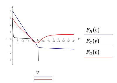

Here is the file I have edited myself. I think the problem, which is also indicated by an error in the mathcad file, is in the qo/qc/col/ccl definitions in prior to the solve block.
I have attached the most current version below.
With kind regards,
Tim
(To:TW_9638511)
You typed C.HL instead of C.CL twice:
I have not compared what else you changed, but I notice that the plots now look quite different. Are they supposed to look that way?
