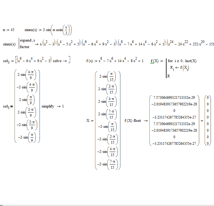

MathCad 14 factored the function sinx(x). It is known from other investigations that this function has only real zeros. If you now look for the zeros of each factor (the terms are in parentheses), then MathCad calculates complex zeros that cannot be simplified. Where is the saw stuck here 😉 .
Kind regards, Alfred Flasshaar
In the sheet you attached I can find no attempts to find any zeros!
Mathcad often displays real numbers using expressions with the imaginary unit. Nonetheless those expressions are real numbers as you can confirm by using "float" or numeric evaluation:
Actually the first solution
is equivalent to
but I have no algebraic expression without using the imaginary unit at hand.

The saw is stuck at numerical precision when calculating numerical results, even from symbolic expressions. I get all real results, sometimes with an imaginary part that is below numerical precision. That is: where the real part is in the order of 1, the imaginary part is in the order of 10^-19  to 10^-21. You can/should discard such imaginary parts.

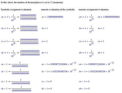

Then MathCad isn't that precise with algebra (Galois, Rufini, ...)? In the complex plane, a number is to be regarded as real from arithmetic point of view if it is not only represented exactly on the x-axis, but is also contained in an x-strip of finite but small width along the x-axis. That takes some getting used to for me.

In general Mathcad is pretty precise as long as it can remain in symbolic mode. However, as soon as it needs to switch from symbolic mode to numerical (floating point) mode, the precision drops to IEEE floating point precision, which means that you get about 16 digits of precision:
Now the symbolic solver will switch to floating point mode e.g. when solving higher order polynomes, since the symbolic solutions only exist for 4th order polynomes.
is equivalent to

This is as close as I get:
(To:LucMeekes)
Yes, but Mathcad is just applying the elementary equation
neither algebraic nor avoiding the imaginary unit.
In MC15 it something similar can be achieved with
I am not sure if a simple pure algebraic expression could be found.
The Re and Im functions are convincing.
It seems to be:
Best Regards.
