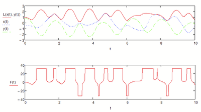

See here the result with three different end-values and notice the magnitude of the force values.
Force seems to be rising and positive in these scenarios but the error thrown ("number with magnitude greater than 10^307) when calculating L(F(t)) would only occur if F goes below -1413 ?????

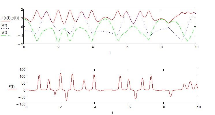

Does this make more sense?
(To:AlanStevens)
So the initial force F(0) is zero in your approach?
Valery demanded it to be F(0)=-8.496 but so his first equation x^2+y^2=L(F)^2  is not fulfilled .

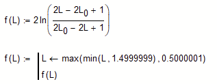

It looks like L exceeds the valid range from 0.5 to 1.5 during the solving procedure which results in wrong return values of your function f(L).
This is the reason the odesolve block fails when I replace your interpolating function f(L) by the symbolic inverse
as it would return non-real values which odesolve doesn't like at all.
If I limit the range for L
also the force is limited
Not sure which approach fits Valerys problem better.
