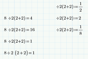

Here is Prime:

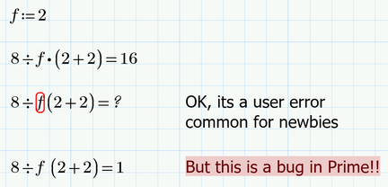

The file was never saved and is lost now but I kept a screenshot revealing the bold "secret".
The last line shows how it looks legitimately from a display point of view. You may notice, the on contrary to real Mathacd, the result of prime is WRONG!!!! If we delete the explicit multiplication sign to make an implicit one, Prime gives a wrong result and obviously assumes a pair of parenthesis which is not there! An impicit and an explicit multiplication should give the same result (as its the case in Mathcad).

Yes, and this is what I consider a bug because there should be no difference between an explicit and an implicit multiplication.
BTW, real Mathcad does not show this bug:B.png

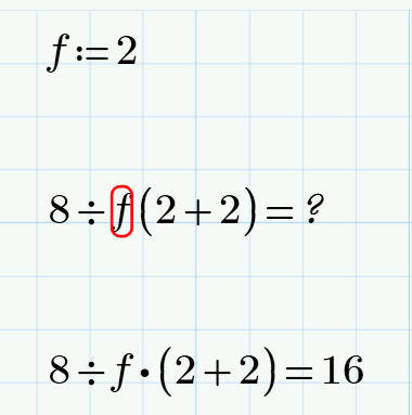

The symbolics in Prime shows the same bug which is not much of a surprise as the problem is not the symbolic or numeric engine behind the scenes but the user interface and parser which had to be written from anew for Prime.
In Mathcad the implicit multiplication (when you input 8 ÷ 2 (2+2)=) and the explicit one (typing 8 ÷ 2 *(2+2)=) give the same results as it should be. Defining the functions means that we first have to type the expression with a number in front of the opening parenthesis and then replace it by b. Otherwise we would create a function call if we just type b(b+b).
Of course Mathcad delivers the correct result also when using the symbolics.
BUT! While playing around in Mathcad I somehow (don't know exactly what I did) was able to create an expression which show the same error as the one in Prime.
I could not spot any difference between the two (I attach the MC15 worksheet) and so I converted the sheet to Prime (Prime replaced every implicit multiplication by an explicit one) and so we see the structure Mathcad/Prime believes we had typed.
Despite all of this - if we type "8 ÷ 2 (2+2)=" Prime must return 16 and not 1, so I still consider it a bug. Not that severe, as the character ÷  sure will be very seldom use for dividing, but a bug.

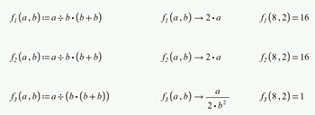

Or to show it with a simpler example:
The implicit multiplication should make no difference.
But, alas, here i came across an inconsistent behavior in Mathcad, too, when evaluating symbolically:
Putting parenthesis around a single variable should make no difference.
