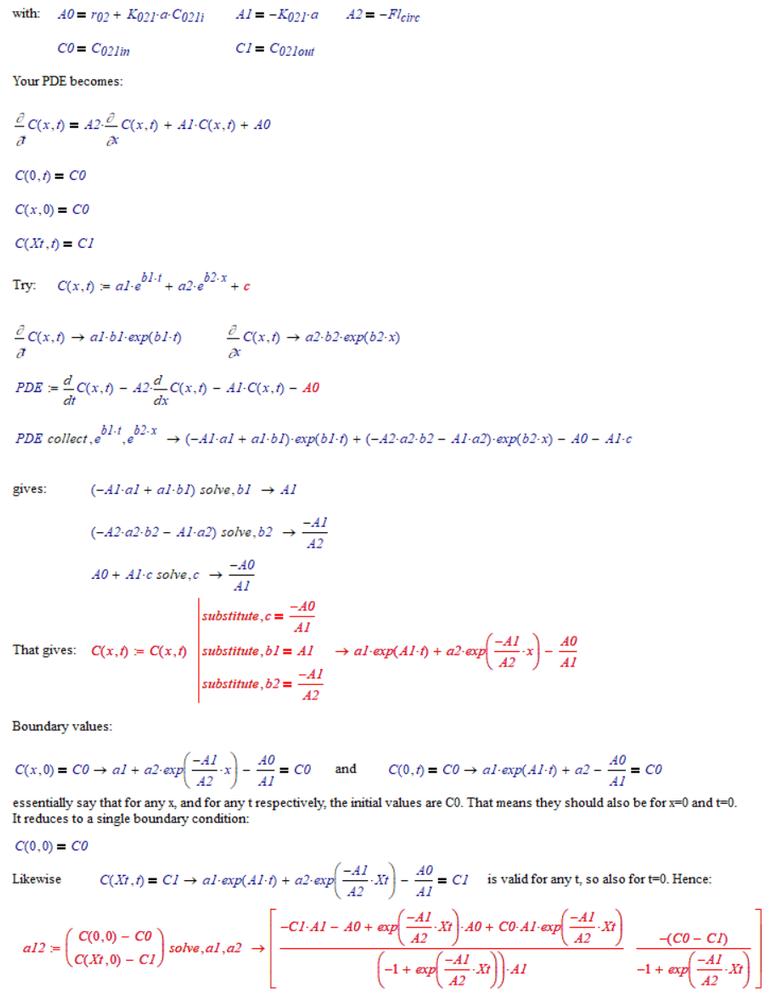

Hey all,
I'm trying to solve equations for concentration which change over space (x) and time (t)
I never work with PDE, usually only ODE. So of course it does not give results like i want.
Can you please help?

Maybe this helps:
Ah okay it seems way more complicated but sure i will try your approach.
Thank you

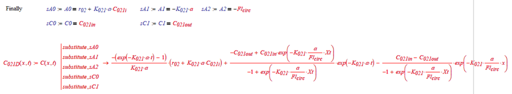

Hi SavitriN,
The way you set up the problem, it seems that you want a numerical solution. If so, all the values of the known terms, the initial and the boundary conditions are missing.
LucMeekes
(To:-MFra-)
Once these values are supplied, the numerical solution can be obtained with pdesolve, and compared to the symbolic solution...
Yes, i do need the numerical solution. And on the original file i have the value for everything,
but it does not work..
