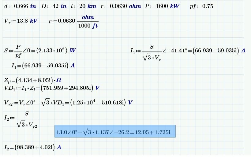

New to mathcad, iterative
Beanie
2-Explorer
why won't this work?
 i am trying to get it to iterate so i can have multiple VR outputs till the VR's start to be the same value i can't even get this thing going right.
 The problem i am trying to solve is finding V source using the iterative method.

 Hi Beanie
Zi's measure unit was missing.
