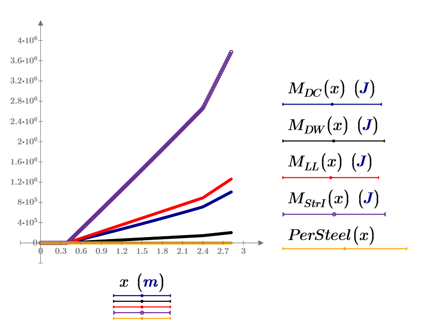

Relatively new user of MathCAD here. I am trying to define a series of piecewise functions using if functions, then plot them by evaluating the function over a vector with a simple programming loop. When I define the input vector (i.e. the x points) using elipses like so:
x:= 0 ft, 0.05ft .. 9.25 ft
, I get an error. When I manually define an input vector ("Matrix/Tables" tab, "Insert Matrix") it works. Two questions:
1) Why is this? What is different between the two definitions of the input x vector?
2) Is there a more efficient way to define the input vector than manually defining a matrix? Is there a more efficient way to be doing this in general?
Okay, so I lied about only 2 questions. My worksheet is attached.

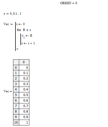

The first half of the image below gives one method of generating data using range varaible.
If you've already defined your range variable, then it should be possible to use it directly in a for loop.  I'm not sure if the program below will work.  I think it should, but I've only got Prime Express.   The Express variant of Mathcad has no programming functionality, so I can't check.

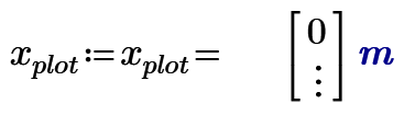

Put the xplot:=xplot=  after the range definition.  "=" is required. then sheet can do all.

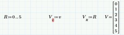

You can also use the following routine to move from a ranged variable to a vector:

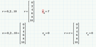

All that said, there's one more thing you need to be aware of. Prime has this miraculous dangerous (and undocumented) feature that if you evaluate a range in its definition, then it becomes a vector.
See below:
r is defined as a range, it's not possible to index it (You cannot address an individual element of a range).
v is defined as a range, but immediately evaluated, that makes v a vector. In his post, ttokoro did essentially the same, but with a previously defined range. It is shown here, to the far right also.

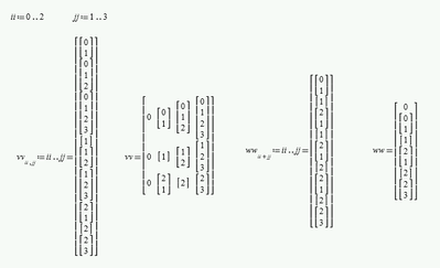

It's very important that you (learn to) understand the difference between a range and a vector, because there are certain things that one can do, and the other not.
You cannot use a vector to index into a vector. But a range can index into a vector, it's one of the means to construct a vector. On the other hand, you cannot index into a range, as was shown above already.
