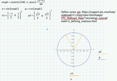

I'm relevely new to Mathcad. and today i run into a weird issue.
I have created a plot. and the first trace works as expected. The second one... the data is there but it isn't plot the way as i expected.
With symbols on i see the dots. but the line in between isn't plotted, and i don't have a clue why it isn't plotted at all.
I have tried to change the circle to also have 3 points what works perfect. The example here defines also data and works also. I tried changing data; plot types; etc, but nothing works.
I hope somebody here has an idea
rgunwaldsen
(To:jw_CS)
Make x1 and y1 column vectors by transposing definition row vectors.

The plot works as expected and you correctly had linked to an example for the so called "waterfall" plot.
Here a couple of vectors is plotted over other vectors.
In this example you can three separate traces because the matrix with the most columns has three columns (the y-matrix). Therefore the last column of the two-column x-matrix is also used for the third trace.
Each trace consists of just three points because the matrix with the least number of rows has just three rows. The fourth row of the y-matrix is not used at all. (And yes, one could certainly argue that it is somewhat inconsistent to use the maximum number of columns for the number of traces, but the minimum number of rows for the points to be plotted for each trace.)
The points of each trace are connected (depending on the line style selected in the plot menu), but the three traces are NOT CONNECTED to each other.
As is explained in the example you linked to, that's similar to creating three separate traces. The difference is that if you create three separate traces you could select color, line style. etc. for each trace separately, while in a waterfall plot all share the same settings.
In your example you provide two matrices with three columns but just one row.
That way you get three not connected traces but each of them consists of just one point (because there is only one row).
If you follow the advice of @rgunwaldsen  and transpose your matrices you get just one trace (because you provide just one column) which consists of three connected points (beacuse you provide three rows), which is what you seem to have expected.
As its just one simple trace we won't call it "Waterfall" plot, though 😉

jw_CS
(To:Werner_E)
I give a little bit of clarification.
I have more or less a python (numpy; scipy; matplotlib (mpl)) background.  As long as it is a 1D array mpl don't care about direction. they are basically the same. So i'm / i was a bit surprised that  for Mathcad it makes a big difference.
The link to waterfall was more or less that i didn't see an how to for the normal line plot. I was looking for the info that @rgunwaldsen give but also thanks @Werner_E for the explanation (specially about the ignoring the last index(es), what is at least as weird as the required directionality)
