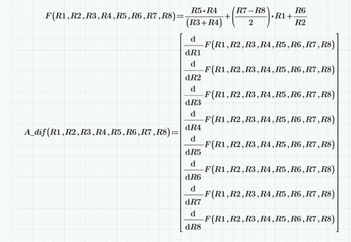

You can.  It's a lot of typing!.

I had this as a solution, but I was expecting something that uses a for‑statement, because sometimes my functions have 100 variables. I would like to automate the process.

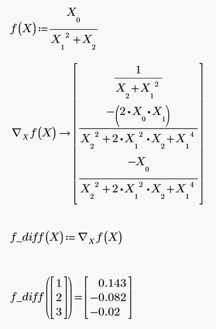

A function with 100 arguments?
So these arguments better are provided via an input vector instead of listing them individually.

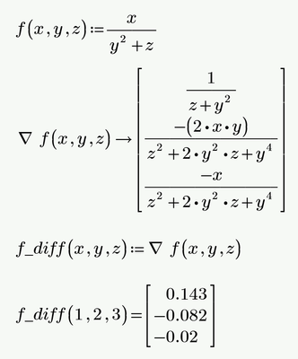

As an example the same demo function with three arguments as posted before
P.S.: I am not sure if the gradient operator already exists in Prime 8, though.

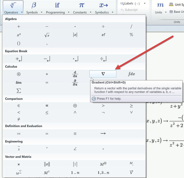

EDIT: I just check and it seems that the gradient operator was not present in Prime 8
See: Solved: Representing Del Operations [curl(u), div(u), grad... - PTC Community
The operator actually was introduced in Prime 9.
Any chance you can upgrade your version of Prime?

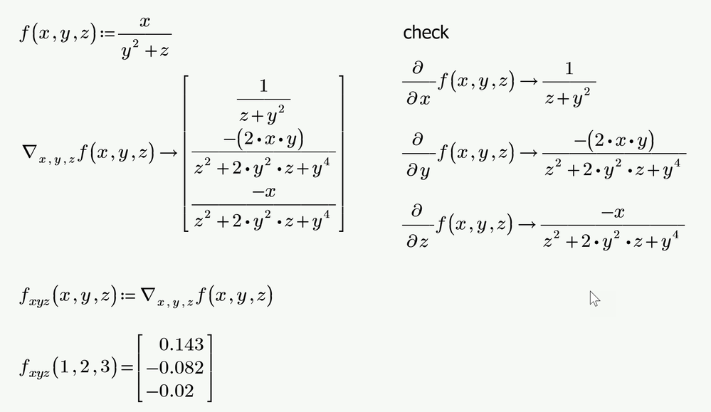

This is what the Nabla/Gradient operator is to be used for. Can be used symbolically but also numerically

OK, I gave it a try and here is my best approach to automatically get all partial derivatives without using the gradient operator.
The method sure has its drawbacks and if ever possible you should switch to Prime 9 or higher where the gradient operator is available.
The attached file is in Prime 11 format as I don't have Prime 8 installed. However, you can certainly follow it based on the screenshot.
Hope it works OK in Prime 8 and can be of help.
