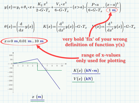

I guess something is not working with units for my plot can someone have a look and tell me what's wrong

LucMeekes
(To:TR_9781963)
Check your formulae.
y(x) adds y1 to k1x^2/2*G*Tx. y1 has units [m] and k1x^2/2*G*Tx has units [1/m].
You cannot add apples and pears.
(To:TR_9781963)

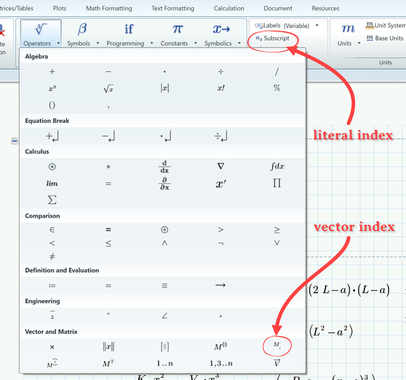

Additional to what Luc already said:
.) Don't use vector/matrix indices unless you really want to create vectors. Use literal indices instead.
.) if you wan to create a plot with units at the x-axis, you have to define a range for the x-values:
Prime 9 sheet attached
