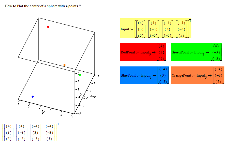

Hello Everyone.
From the following :
Thanks in advance for your time and help.
Best Regards.
Loi.

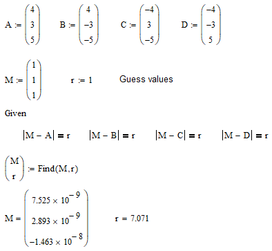

(To:lvl107)
How about using a solve block?
In case of your data the centre of the sphere is exactly the origin.
You can increase the precision by setting something like CTOL:=10^-8

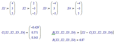

lvl107
20-Turquoise
(To:Werner_E)
I greatly appreciate your time and help. I'm very happy with your help. My question would be the following : (just only changing the GreenPoint)
Thanks Again.
Loi.
(To:lvl107)
Just type in the solve block and throw in the coordinates you are interested in.

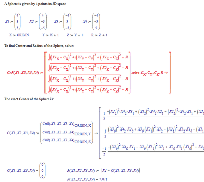

LucMeekes
(To:lvl107)
Note that the exact expression of the center is large, in full it is:
With another set of points, you may get:

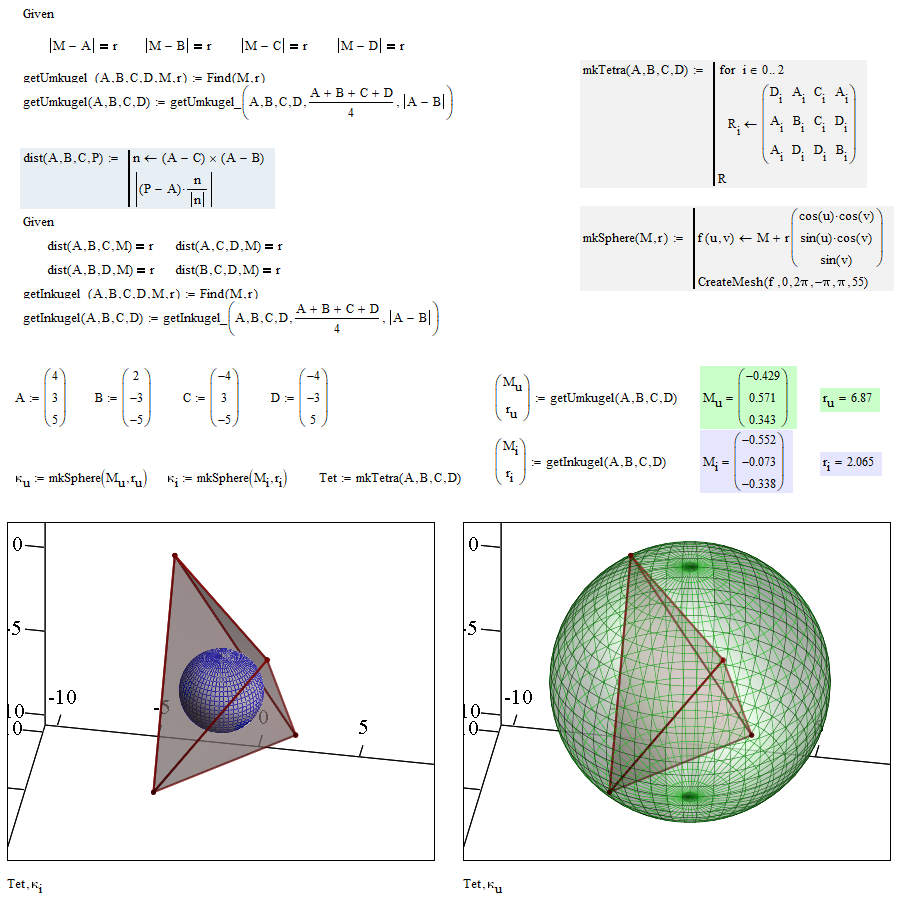

(To:lvl107)

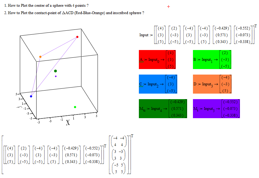

lvl107
20-Turquoise
(To:lvl107)

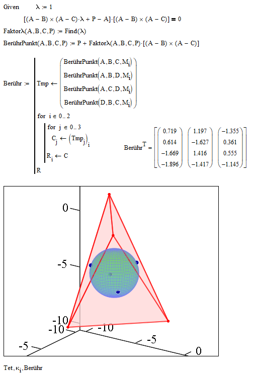

Hi Everyone again,
Until now, I got 2 new points of center. (DarkGreen and Violet). And I still have another query : 2. How to Plot the contact-point of ΔACD (Red-Blue-Orange) and inscribed sphrere ?
Thanks in advance.
Best Regards.
(To:lvl107)
EDIT: Mathcad 15 file finally attached
