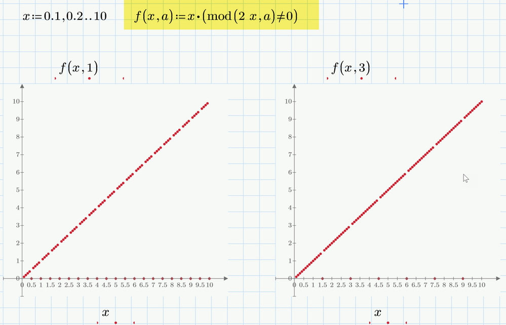

The answer to your question:
Because x/a is a scalar when f(x,a) is called through a plot and you cannot compare a scalar with a range.

mod condition does not match. So return no data. Not last(x) but last(p). Add else condition.

(To:Cornel)
Look up the "match" command in the help!
At least if you mean what you wrote - just looking for the exact value 0,5.
If you are looking for integer multiples of 0,5 (0.5, 1, 1.5, etc.) you would also add the mod command.
ttokoro
(To:Cornel)
Only change the condition.
And if you want the line number of the match data, just set the answer with index i.
(To:ttokoro)
You are filtering the p-values which are integer multiples of 0.5.
I may be wrong, but as I understood @Cornel  wanted to filter for the x-values where x/a is an integer multiple of 0.5.
Your function does not make use of its argument a in any way!?
On contrary to what he asked first in his last posting he wanted to see the values of x which are 0.5 (not multiples).
So actually I am not sure what he really is looking for ...
