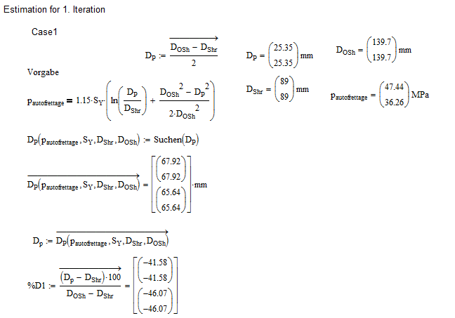

Hey, im encountering an failure here:
I want to use for every row another Dp as shown here:
Thx ! 😃

Not much can be said about your picture as we don't see the type (scalars, vectors) of your various variables.
You also don't reveal why you think that you are experiencing is a failure.
Probably Mathcad is doing right anyway. Could it be that you simply don't know that you can tell Mathcad to show nested matrices via format menu?
Otherwise - explain what the failure is in your opinion and maybe you can post a simplified (!!!) worksheet to demonstrate the faiilure.

Hey thx for input.
My problem is that i need the Search function and i need a certain starting point for searchig.
The input parameters are all normal values and the starting point for the search function is depends for every row (loadcase)
I think werners post is the right one.:
Werner: 13.04.2016 02:45
i still dont know what nestet matrices are. I was thinking it as a failure because the output is not a normal vector.
Im gonna try tomorrow.

(To:sm�ller-2)
The functions arguments may be scalars, but it seems to me that the guess value for Dp is a 2x1 matrix and thats the reason your function Dp returns a 2x1 matrix for every set of input values.
Was that intended and done on purpose?
We talk of nested matrices when the element of a matrix is a matrix (or vector) itself.
Displaying nested matrices can easily go unclear and confusing, so the default setting is not to show matrix elements which are matrices themselves but rather represent them via their dimensions, So {2,3} means that the element is 2 x 3 matrix (two rows, three columns).
If we (can) display a matrix as matrix (and not as table), we have the option, to display the "inner" matrices as well.
Now, why did you get nested matrices? We still don't know much about your variables, but I guess, that your function Dp() returns a 2 x 1 vector when called with simple scalar arguments.
When you call it vectorized with a vector of scalars as argument, the values of that vector will be fed in your function one after the other and the results (a 2x1 vector for every call) are collected in a result vector - you will end up with a vector consisting of a number of those 2x1 vectors.
If you need another data structure, you will have to write a small program to turn the nested matrix into whatever structure you expected. - maybe a n x 2 matrix?

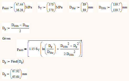

Ok here is my input for the search function:
as to see my guess value is a Vector with 2 rows. Here: 25.35 for the first and the same value for the second.
It is also possible that the input vector for startening the iteration has different values for the rows. For example: 25.35 (first and 120 for the second).
It is also possible that i have more than 2 rows.
So as to say i want to do the Iteration for every row. And mathcad should take the vector (Dp, here 25,35 anf 25.35) as startening point for the iteration for every row independend.
The solution here should be 67.92 and 65.64.

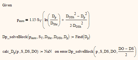

Try removing the vectorization. If that does not work for some reason, pass the guess values as an argument to the function Dp (this is really the preferred solution anyway, because it should always work):
(To:sm�ller-2)

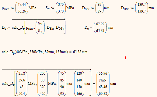

You have created a function to calculate D.p and the guess value obviously should depend on two of this functions arguments. So the guess D.p should not be static as in your sheet as you need different guess values if you call your function with different values.
Unfortunately we cannot calculate the guess value in the solve block but at least we can pass it as a function argument. So I have chosen that the function which is called to calculate D.p first calculates the guess value and then calls the solve block function with this guess as additional argument. I also added the "onerror" statement to cope for input values which make the solve block fail.
Now you may call this function with scalars or vectors of any size (given they all are of the same dimension).
You did not show if S.Y is a vector or a scalar. If its a vector, you need vectorization, otherwise you should use vectorization but you mustn't.
But I have the impression that you did not want to create a function to be used multiple times with different input values but simply wanted to do the calculations just once but with the values in your vectors one by one. If thats the case you might do it the easy way like this:
