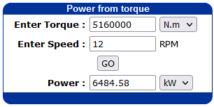

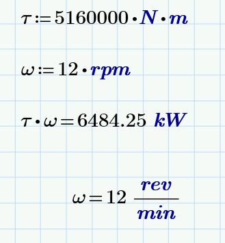

Having already discovered mathcad's rpm "unit" is radians per min and not rotations. I am having a new issue trying to figure out why I'm getting incorrect solutions for power. 
c128a334-2e55-4538-ad89-9cc3a3810577.png Wrong
0c2dc48a-6c03-4fb0-b627-5c4fd9640817.png Correct

This form works fine in Prime 8:

not sure where the  .58 in the calculator of your screenshot stem from. Must be a wrong or very inaccurate approximation of pi?
EDIT: I just found the site with the calculator you used and it uses a factor 9.5488 which actually should be 60/(2 pi)=9.54929658...
rev=2pi not 1
