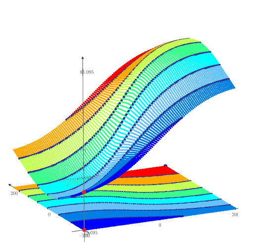

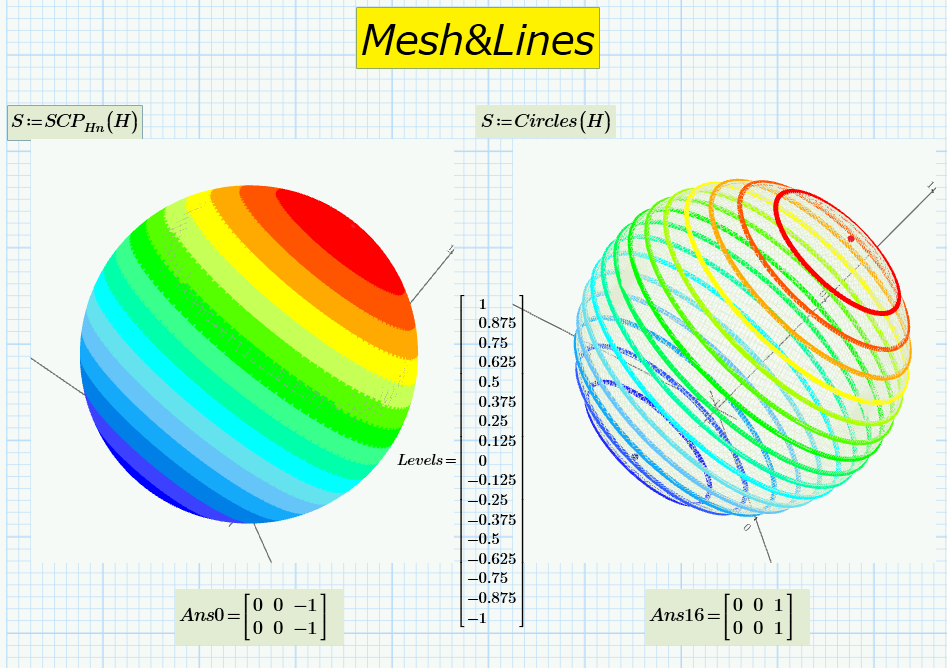

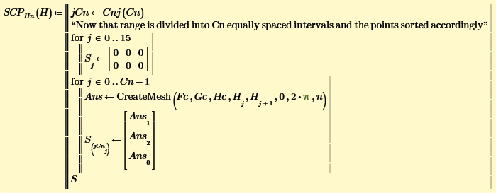

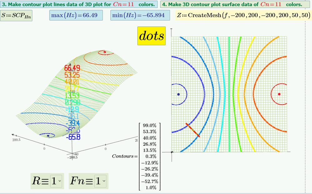

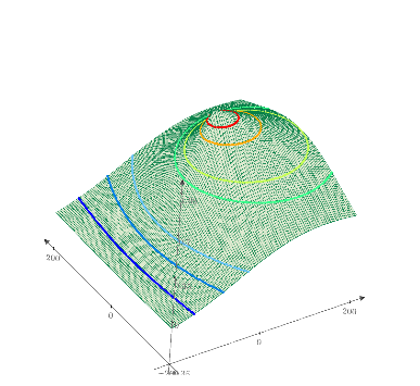

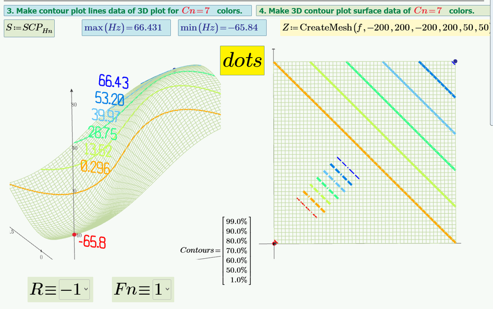

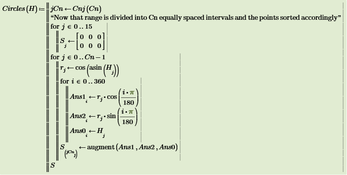

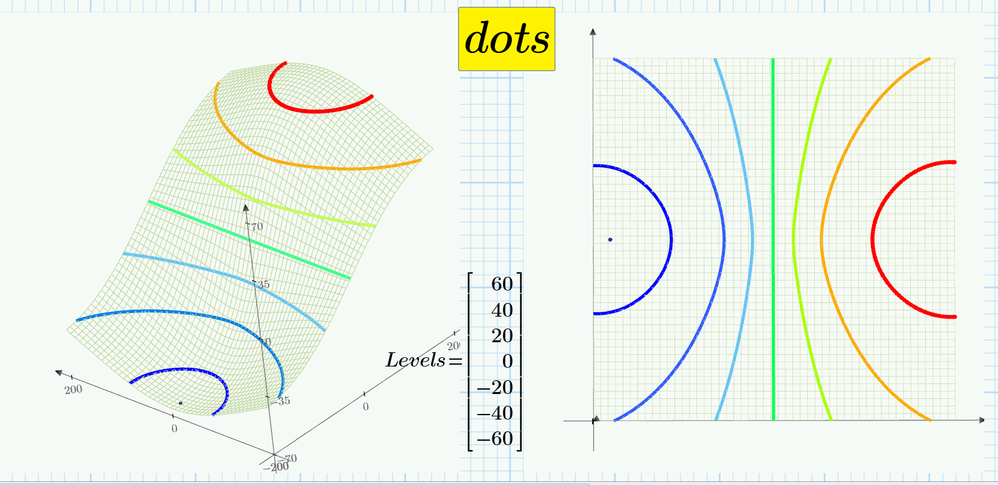

ttokoro
(To:ttokoro)
Contour plot levels can use vector of rows from 2 to 16.
Also set the contour levels as you want.

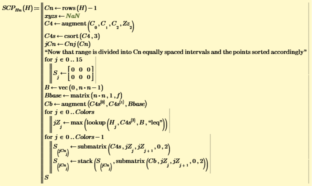

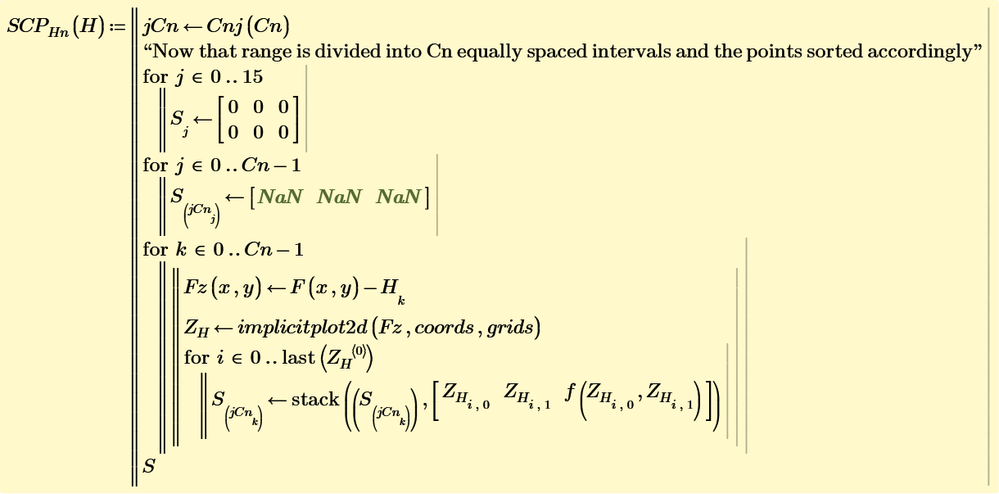

ttokoro
(To:ttokoro)

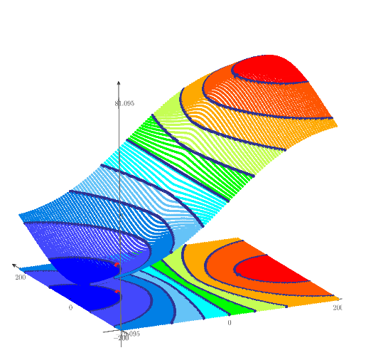

ttokoro
(To:ttokoro)
Add z contour level texts in 3D plot. Contour levels are each 100%/(Number of contour lines) or what you want to see. Text direction is also changed by light direction.
ttokoro
(To:ttokoro)
