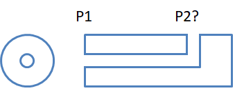

Hi!
I was wondering if someone can point me in the right direction.
Suppose you have a cylinder with a center drilled hole, at the end of the hole a perpendicular hole is drilled through the cylinder wall as shown below:
How can i calculate the pressure drop if the fluid flows from left to right.
The fluid is turbulent
Regards
Sigurd

People have been trying to solve this (with accuracy) for a long time.  A good finite element model, properly set up, will come close. There are numerous handbooks (Crane Company used to put out a really good one) that can assist an empirical estimate.
There are a lot of variables:  hole diameter, lengths, effective radius of the turn, Reynolds Number, etc.  The sharp turn at the end is the major problem.

In order of preference:
a.) experiments
b.) CFD
c.) Equations.
d.) Tabulated loss parameters (k-factors or minor losses)
C & D are easiest.
For C here's one example that I'll assume has something close to your problem. (Idel'chik)
https://www.nrc.gov/docs/ML1220/ML12209A041.pdf
Crane Technical Paper 410 is good, as Fred points out - but not free.  Any fluids book should have some minor loss factors to get you going.

A careful web search can reveal a pdf of Crane TP 410
