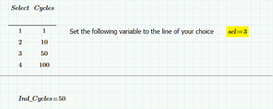

Prime features these fine Tables (See "Matrices/Tables" tab). Tables are ONLY for input!
You can do this:
I'm afraid this is it. You'll have to live with it, or run back to Mathcad 15.

Thanks @LucMeekes, this was very helpful.  It would be nice to have the simpler options but if I do have to use Prime than I can make it work.
