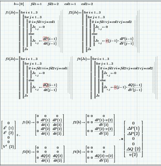

Greetings, im trying to program something that fills a matrix automatically, but you can choose wich rows and columns to make 0 instead.
So far i can do it by hand, just setting what row and colum i want (fil=row), and adding extra conditions to the "if"
I tried to use a matrix instead, like row:=[1 2 3], so if i= any of those 3 values, it assign it 0, but it doesnt seem to work with a matrix, i wrote it something like "if i=fil1_i" (_i meaning subscript), but it doesnt compare it to the value on the matrix.
Im working with Power Flow equations, in this part i need to do a 2x2 matrix each space being a Jacobian matrix. Im trying to automate it, because this is with 2 "bars" so matrix are 2x2, but when its something like 6 bars i dont want to do everything by hand

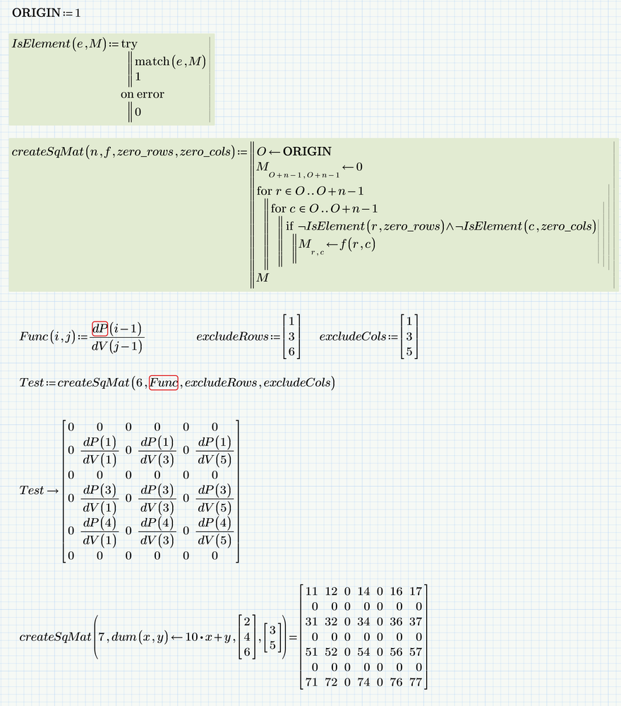

I am not absolutely sure what you are trying to achieve, but maybe this function could be of help:
Prime 6 sheet attached

Here is a slight variation

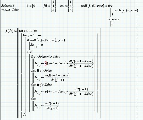

Thanks, that match function is just what i was looking for. Plus i did something so i can put four 2x2 matrix on a single big matrix (since the jacobian matrix is like that) to adjust the subindex so it starts at 0 when you reach each cuadrant (note that i changed matrix origin to 1, hence those i-1).

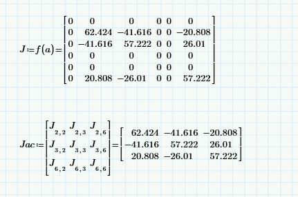

Now since you finally have to work with the actual values of that matrix, im looking into, either dont fill those rows/columns from the matrix so it ends up as a 3x3 in this case. Or take the info from this matrix and remove the required rows and columns, so i dont need to make a new matrix and manually put each element looking at the original matrix.
So i applied that same program to calculate the actual values, and like i asked before, how could make a new 3x3 matrix with the non 0 values, so i dont have to do it by hand?, either by adding more commands to the program that gives me this result, or to trim the result matrix

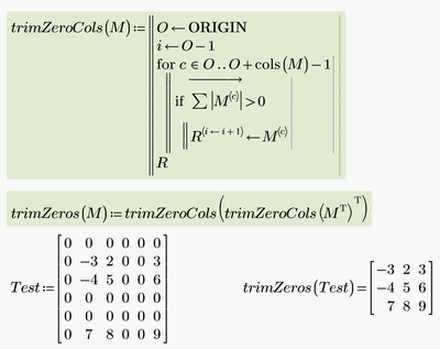

There might be better and more elegant ways, but here is a quick first attempt for a function which trims all rows and columns which consist of all zeros:
Prime 6 worksheet attached
(To:Werner_E)
Here is a version without the "IsElement" function

Thanks a lot. I was trying to understand your method, the just do columns but transpose and transpose back is a great idea.
I have a question since i been using mathcad for this semester only, why is it needed to declare the origin when you start a program? i see many people does it, but i notice i can get away with not doing it at all.
Also i didnt knew you could use the input matrix, do some work and output to a different matrix, that way you can fill another matrix with just the info you want. Thats another thing i was trying to figure out.

The double transposition was done out of laziness as I did not want to write a trimZeroRows function, too. But if you are using really huge matrices, this could be a performance drawback. But by huge I am talking of matrices with much more than a few hundreds elements.
