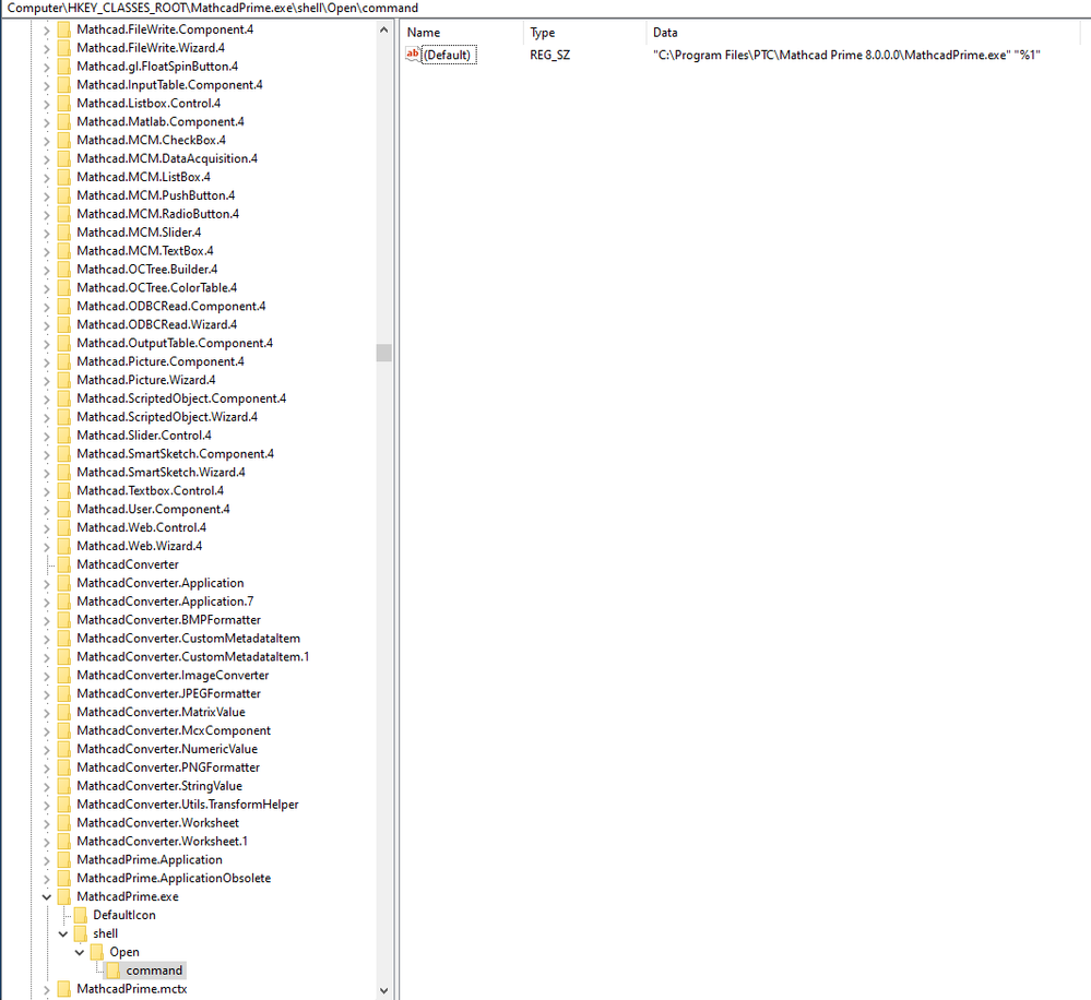

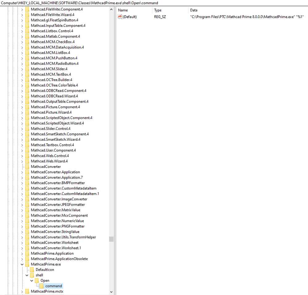

my last tip ... compare registry settings on your computer versus registry settings on another computer.
  • run regedit
  • go to Computer\HKEY_CLASSES_ROOT\MathcadPrime.exe\shell\Open\command folder -AND- look at (Default) value
  • go to Computer\HKEY_LOCAL_MACHINE\SOFTWARE\Classes\MathcadPrime.exe\shell\Open\command folder -AND- look at (Default) value

Concerning the registry settings as mentioned by Martin:
The entry for (Standard)  is  "C:\Program Files\PTC\Mathcad Prime 10.0.1.0\MathcadPrime.exe" "%1"
The entry for (Standard)  is  Open
Thank you both for your replies.
It seems that I have the same values. I attached screenshots to make sure I am doing this properly.
Value: Open
Value: "C:\Program Files\PTC\Mathcad Prime 8.0.0.0\MathcadPrime.exe" "%1"
