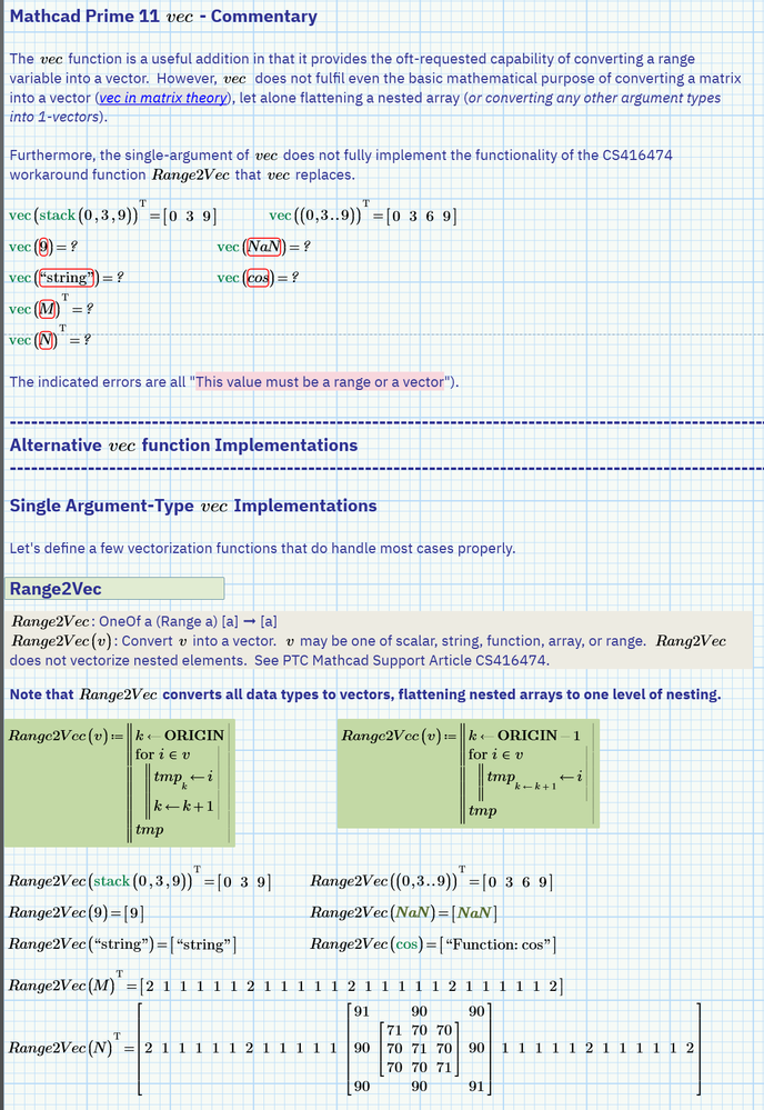

PTC published Mathcad Support Article CS416474 to address the change in Mathcad Prime 10 regarding how concurrent evaluation of range variable definitions was handled.  In CS416474, PTC introduced the function Range2Vec as a suggested workaround for the change in Prime 10 behaviour.
This is where vec is potentially a bug as Range2Vec converts a flat matrix into a vector (in accordance with standard mathematical use).  vec , however, only converts a range into a vector or acts as an identity for a vector.  It does not convert even flat matrices into vectors, let alone nested ones.  Again, whilst I see benefits to Prime's vec , I am disappointed that PTC took no apparent notice of the definitions of vec that have been in use for at least the last twenty years.
(In the screen shots below, M is a flat matrix and N is a nested array (one element is a matrix)).

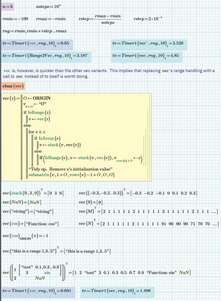

MP11's vec has a further limitation in that it vectorizing (in the Mathcad sense) over vec over a vector just returns the original vector, whereas most vec implementations return a vector whose elements are the elements of the original vector converted into 1-arrays.   Again, Range2Vec supports this latter behaviour.
Here's a demonstration of what I mean ...
Such a shame, as it's good that vec is there, I like the optional argument form, and I'm very pleased to see IsRange.
