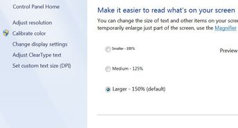

This was the issue with me.  I have 4k monitors and so months ago I had bumped up the font size to CUSTOM DPI 170%
When I switched to 150% thankfully the problem was solved.   I should have looked into it months ago, but I just used Prime 4 express instead.  Good day for me.
I know it's been a long time; however, your suggested fix did the trick for me also.  I did a custom font size to 120% and that worked because the built-in 125% still had the problem for me.
Thanks much.
