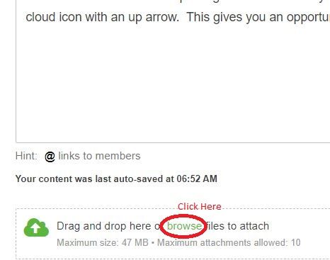

Below the text box used for posting is an area where you can browse and upload files.  It is marked by a green cloud icon with an up arrow.  This gives you an opportunity to browse for your actual Prime file to attach to the post.  Having your Prime file helps in answering your question.
