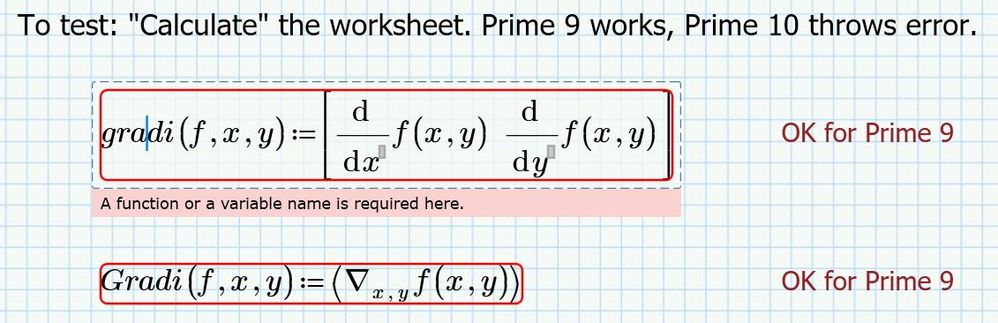

Problem outputtng from function into array.
rgunwaldsen
The depicted snippet works in Prime 9 and I think earlier versions. Fails with Prime 10.0.0.0.
Error.jpgPrime 9 worksheet attached.

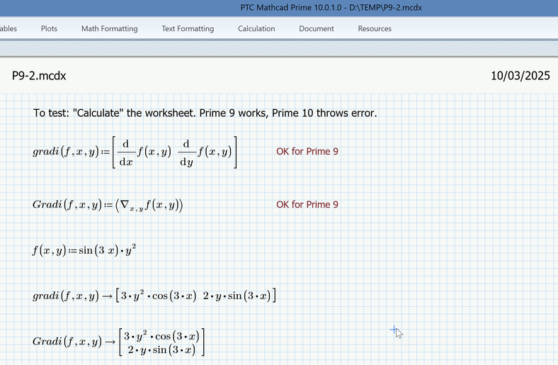

(To:rgunwaldsen)
I can't duplicate the error in Prime 10.0.1.0.
Your sheet works perfectly OK
Maybe it was a bug which was already fixed in the current interims version.

(To:rgunwaldsen)

(To:rgunwaldsen)
@rgunwaldsen wrote:
Thanks, Werner.
This is encouraging. I have held off downloadng 10,0.1.0 putting my faith in the soon-to-be-seen version 11.0.0.0. And as far as I know, there is no "bug-fix" list for 10.0.1.0.
As far as I know there never was a comprehensive list of bugs fixed when a new Prime version saw light. This was far more transparent and better documented at the times of Mathcad (15 and below).
PTC simply says here that you should check the Update Advisor to see which reported(!) bugs have been fixed. There you would have to go through the entries one by one - unfortunately there is no clear collective list.
I had already criticised this on a previous occasion -> Solved: Re: Prime 10.01.0
I think 'your' bug is related to https://www.ptc.com/en/support/article/CS418413
