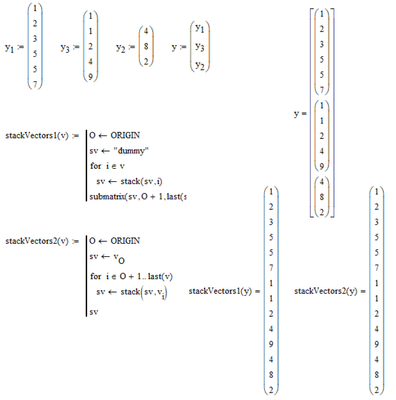

Hi all, I have several column vectors that I need them to be merged into a one big column vector. The problem is that as they have several dimensions, Mathcad add zeros to match their dimension before merging them. The zeros make errors in calculations. I wonder how I can avoid these zeros? Many thanks.

How about this:

try:
stack(y1,y2,y3)
Thank you for your response, but I want to use it in a loop in a way that regardless of the number of vectors (y), the function can automatically do that. For example, if there are 10 different vectors (y), there would be no need to change the function to work. I hope you find my explanation clear.   Best.

How about this:

perfect, that's exactly what I was looking for. Thank you a lot.
And this other?
