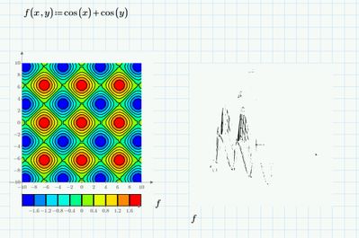

Hi Folks,
Here's a problem I saw on Dell laptop a while back and now have on my new desktop - a Dell running Windows 11.  I made a simple function of x and y.  It looks fine as a contour plot, but the 3D plot won't render.  Has anyone else seen this?
This is the only graphics related problem I've had with either machine, so it doesn't feel like a driver issue.
Thanks for your attention 🙂
Mark

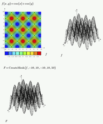

Does the effect occur with every 3D plot you make. What happens if you choose "Surface Fill"?
Does it help to change the number of points from the default 41 to something else?
Does it also show when you use CreateMesh() (maybe with other numbers instead of the 50?

When went back to try again, I added another sheet to a Prime session I already had open and it worked.  When I closed Prime and started again, the problem came back.  Weird.
Alas, changing the number of plot points doesn't fix the problem.  Neither does adding surface fill.  I contacted PTC about this problem when I saw it on my laptop a while back.  They followed up and then I never heard back.  I guess they lost interest.
While I have your attention, I don't see any way to color code height in the 3D plots.  I think V15 used to do that.  Am I missing something?
It took them a while, but I think they have most of the bugs worked out of Prime.  My only remaining beef is the plotting functions.  I can either format a plot properly, with axis labels and grid lines, or I can have 3D plots.  I can't have both.
